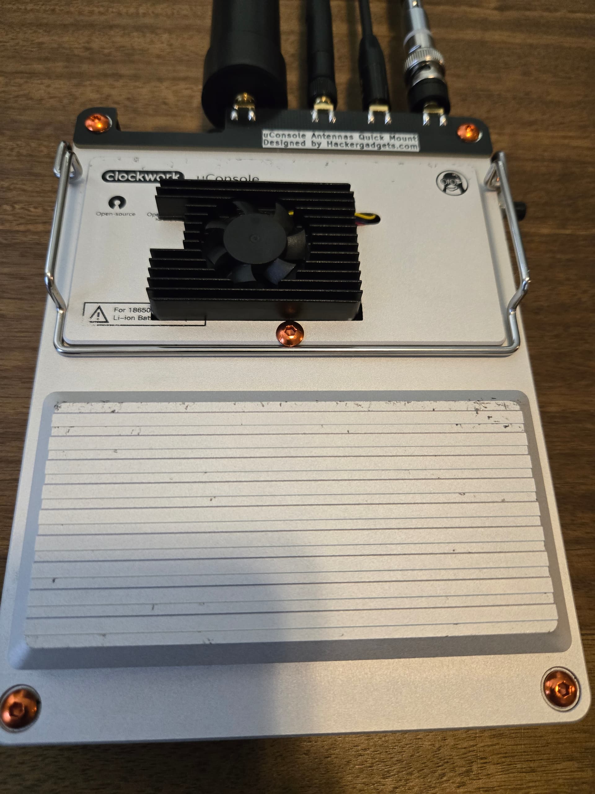

My uConsole is new, so I’m hoping to avoid damaging the original parts. It seems to me that if someone could create a 3 printed spacer (perhaps only 4-5mm thick, we could have a fan on the CM5 processor with a number of slots in the spacer for airflow. This would mean to changes to the original case (so could change back to that whenever required) but offering a proper cooling option that could look decent at very little cost and with very little additional thickness.
I will look to do myself, but if someone has already done something like this, do let me know.

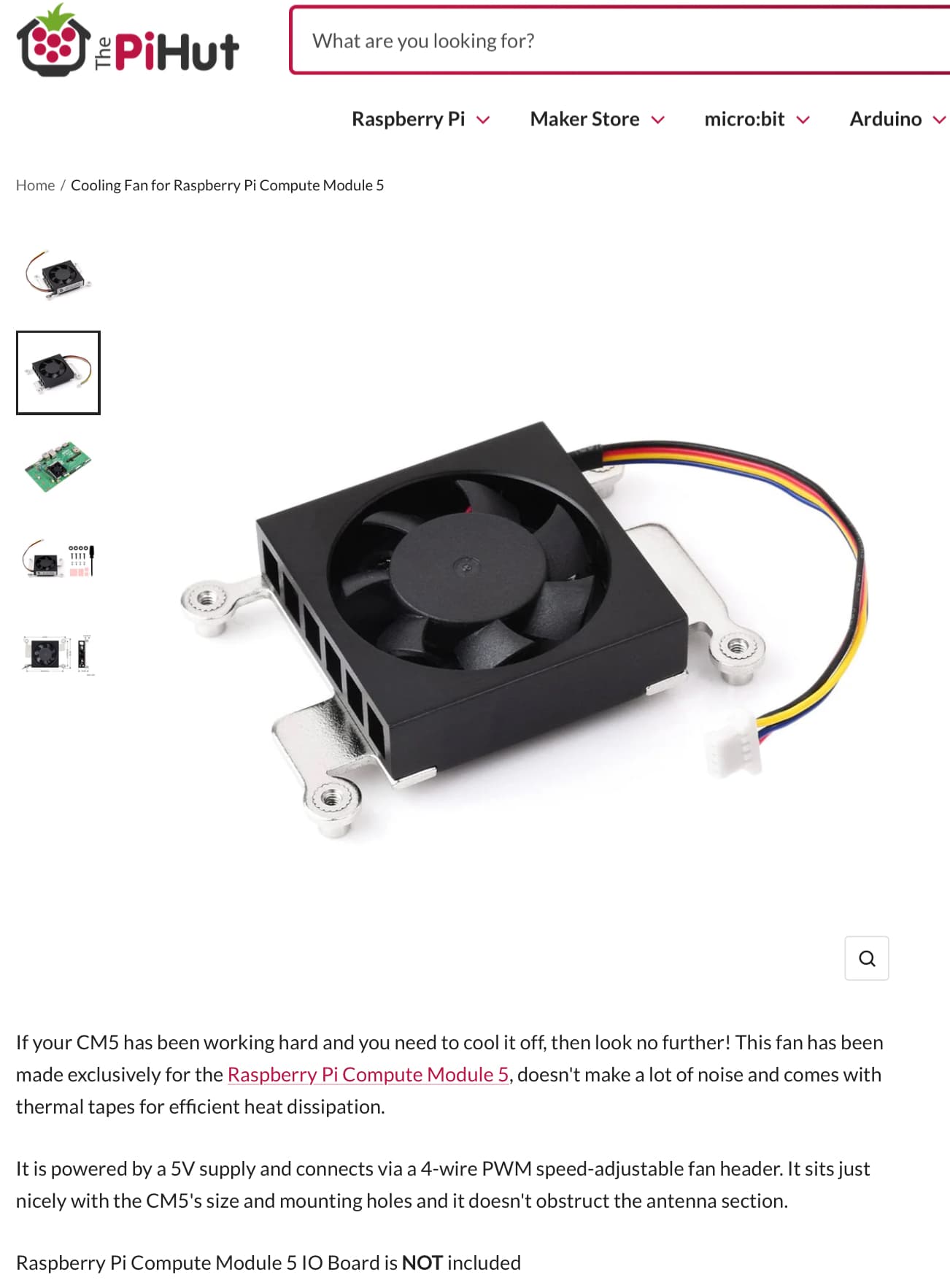

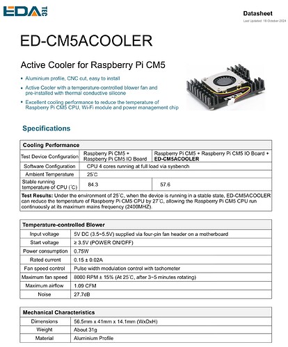

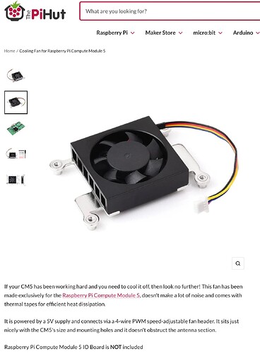

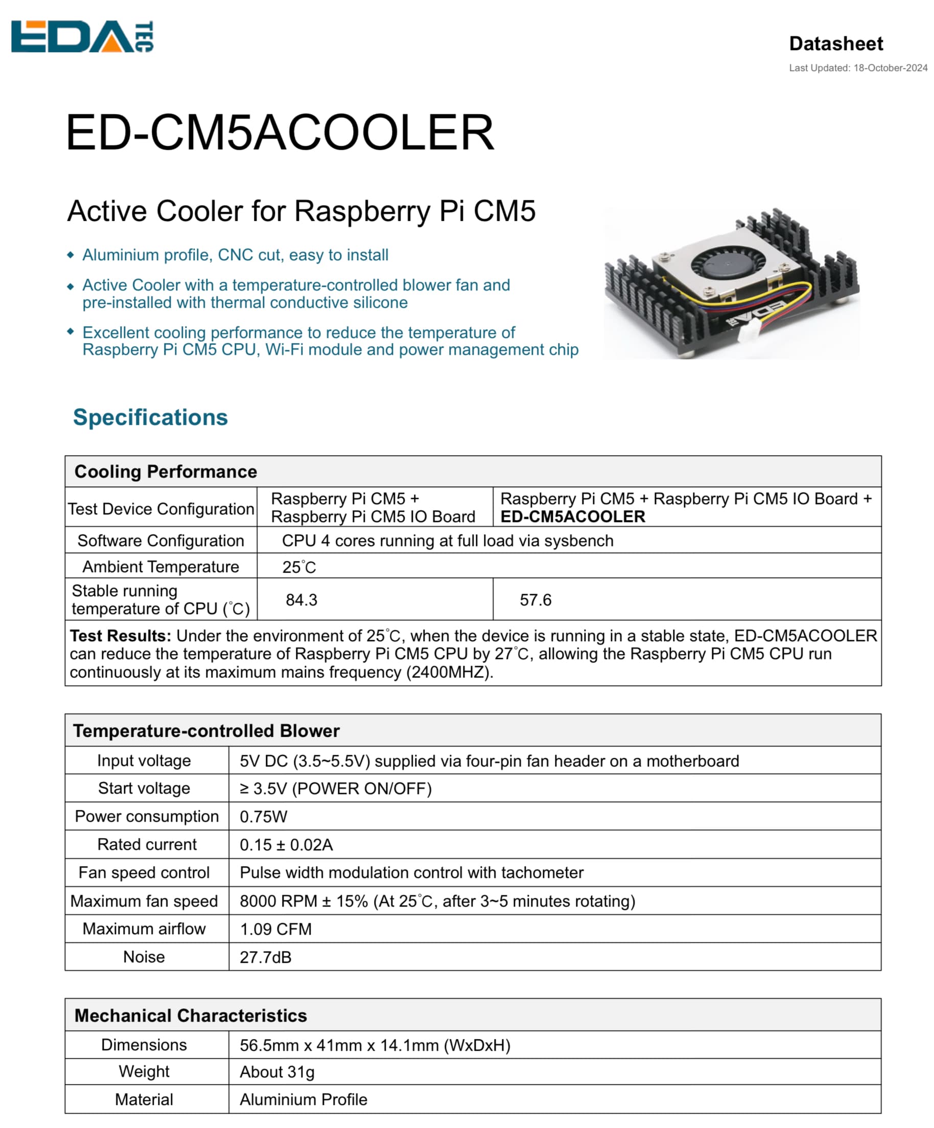

I was thinking of one of the following active coolers. What I would need is suitable longer screws for the case. Does anyone know where I could source black screws of the same time as the uConsole uses, only perhaps 7-12mm longer?
