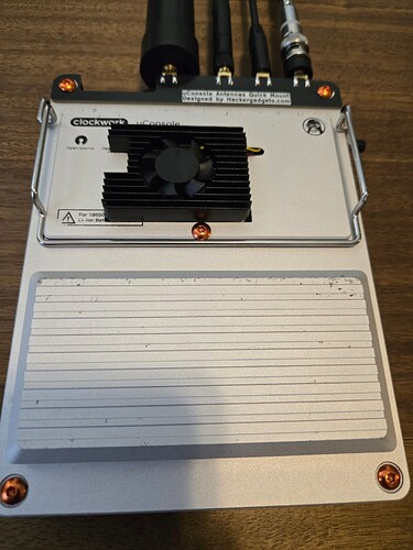

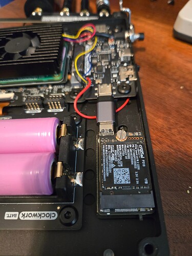

My current solution for the CM5. I wired a waveshare heatsink and fan to the the spare usb pinout of the sdr board. I also added a switch so i can control when it runs. It brings it back down to 33-35 in about a minute. I had to cut open the back for heat sink clearance.
