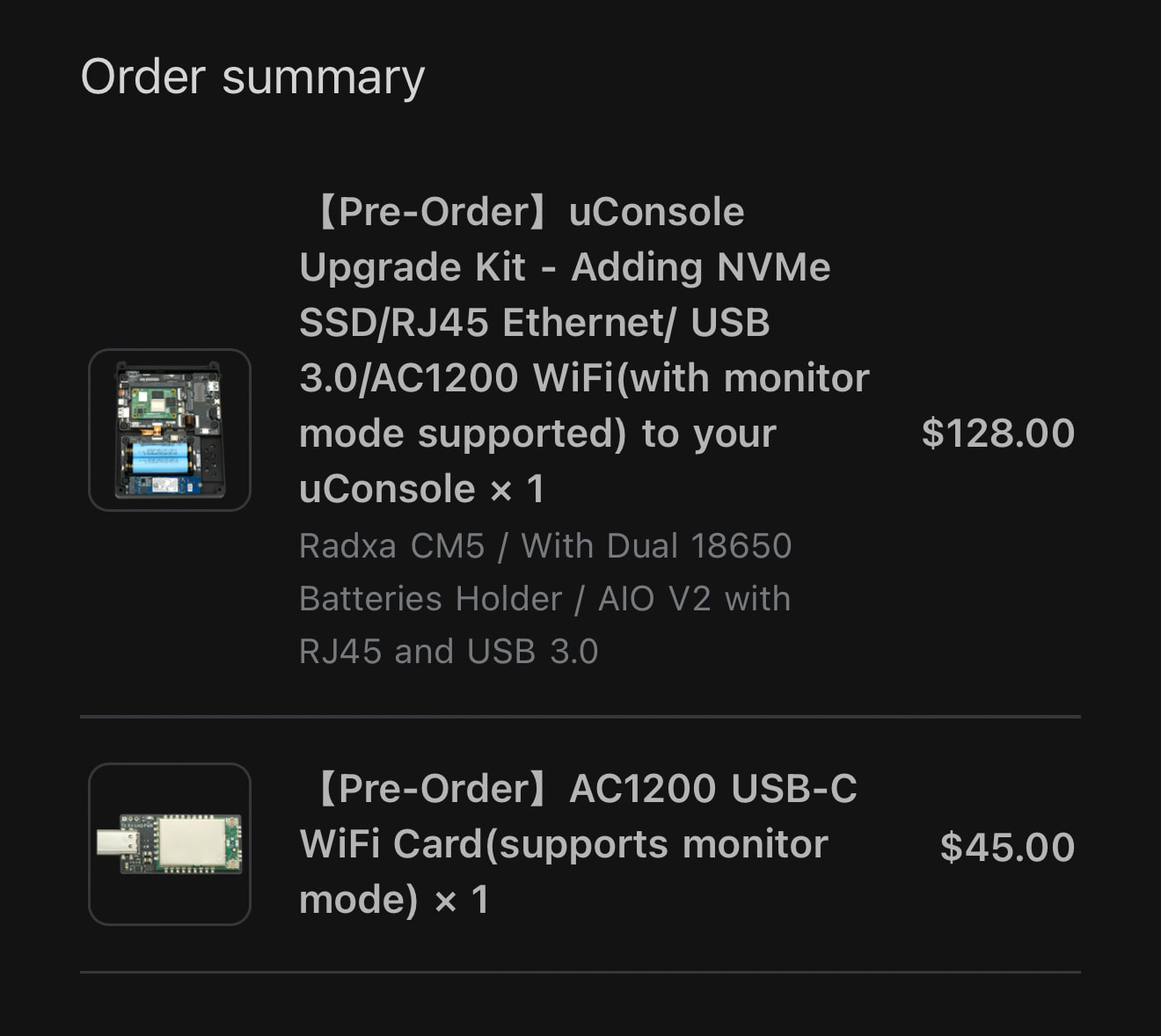

Now just waiting on Hacker Gadgets upgrade….
  1. Will the Hacker Gadgets upgrade enable me to use the speakers?
  2. Will I still be able to use the SD Card?
  3. Will Rex’s image work on Radxa or do I need something else?
  4. Am I missing anything?
  5. Do you think I’m a twat?
  1. Not skilled enough…
  2. Not skilled enough…
  3. Apparently he is always on something xD so maybe…
  4. A question, so with this you can use wifi and SSD with the radxa?
  5. NO! but I am a twat!
