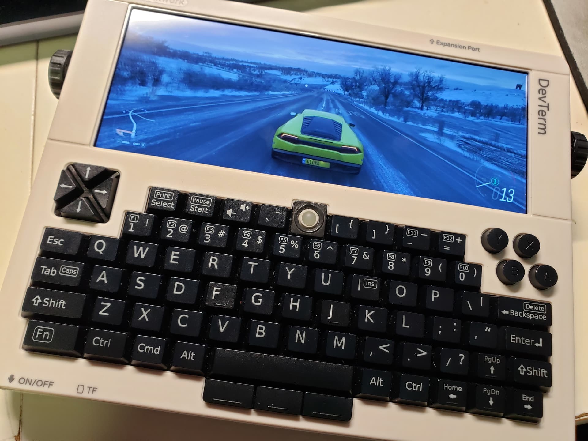

Here is Forza 4 on the DevTerm

The main issue is that the DevTerm’s resolution is pretty low on the vertical. So if you tried to set the host computer’s resolution to the DevTerm’s resolution, most game wouldn’t run since there isn’t enough pixels vertically for most games to render properly. So what I did was to set a custom resolution on the host PC that is twice the DevTerm’s resolution. So instead of 1280x480 I used 2560x960. It’s not perfect, but the result on such a small screen isn’t too bad.
