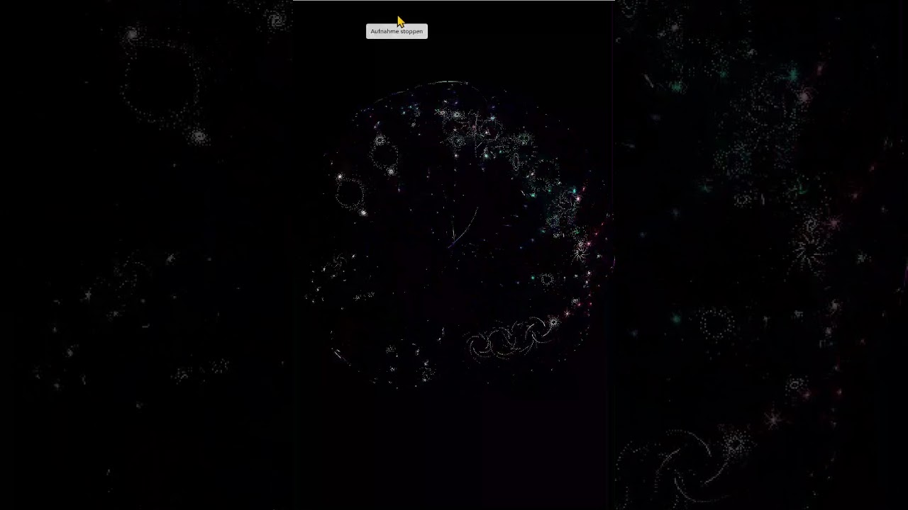

Bubble Universe
Found a cute graphical demo thing and ported it to the picocalc.

I tried to do simular using MMBasic, but to slow.
It took more then 6 seconds per frame.

I just reduced the time per frame by 27%, by replacing the call to Func() with its code inline instead!

Unfortunately doesn’t that either iterate enough on each frame to get those magical swirling galaxies that I like.
Like in the GIF animation from https://x.com/i/status/1226846058728177665)
Bubble
But it is definitly an improvement.
