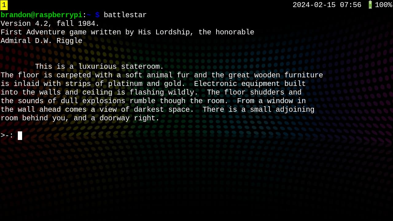

Configuring Sway
I’m publishing my config for the sway compositor. I am managing it via dotbare, for those who are familiar with such things, and want an easy way to get my latest changes.
I have included instructions in the readme to set this up using the official images. If there’s interest, I would be willing to publish pre-configured images.
This is a bit experimental, and some applications are broken under sway (in particular) and wayland (in general), but I already find it much more useful than the default LXDE environment, given the unique nature of the uConsole. I await your feedback.
For the impatient, here’s some screenshots:
