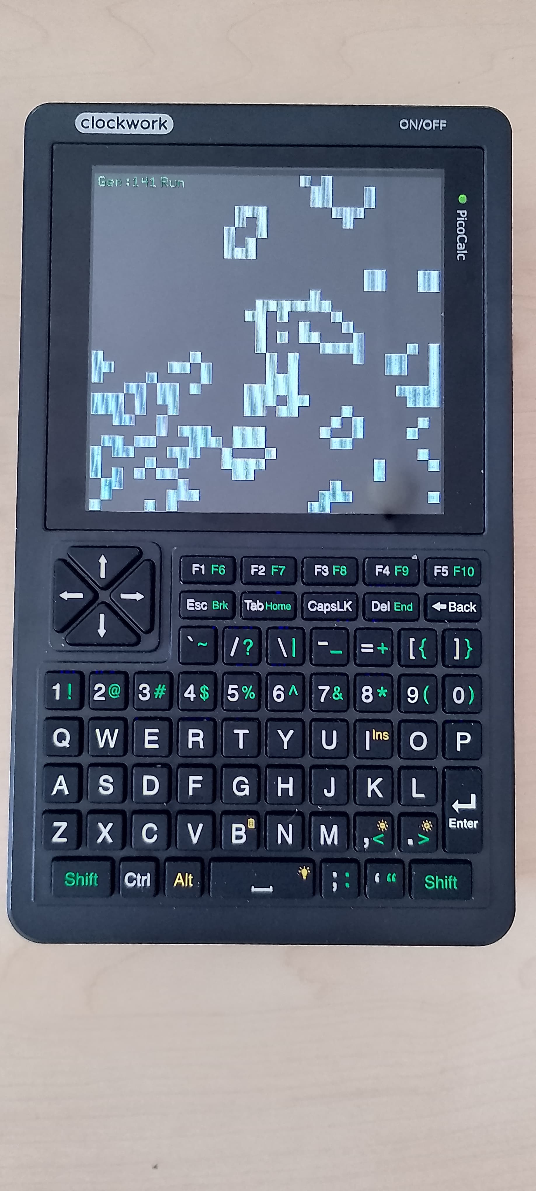

Conway's Game of Life
Conway’s Game of Life
Commands:
ESC to exit the game
R to reseed
C to clear
PAUSE to pause/resume the game
CONST CELL = 10 Higher the number, bigger the cell, faster the game
CONST INIT_FILL_PCT = 25 Variables to play with
CONST STATUS_EVERY = 1 Variables to play with

          If filled=1 Then filled=0 Else filled=1
          DrawAll
        Case "R"         ' reseed
          SeedRandom INIT_FILL_PCT
          DrawAll
          gen = 0: upd = 0
          StatusBar
        Case "C"         ' clear
          ClearAll
          DrawAll
          running$="paused"
          gen = 0: upd = 0
          StatusBar
        Case Chr$(27),Chr$(13)  ' Esc
          If Running$ = "paused" Then
            Running$ = "running"
            If a(EditX,EditY) = 1 Then
              c = wt(fg)
            Else
              c = wt(bg)
            End If
            If filled=1 Then fc=c Else fc=wt(bg)
            Box (EditX-1)*CELL, (EditY-1)*CELL, CELL, CELL, , c, fc
          Else
            If k$ = Chr$(27) Then
              Box 0, 142, 320, 30, , RGB(white), RGB(white)
              Box 3, 145, 314, 24, , RGB(red)
              Text 18,151,"Are you sure you want to quit? (y/N)",,1,,RGB(black),RGB(white)
              k$=""
              Do While k$=""
                k$=Inkey$
              Loop
              If k$=Chr$(27) Or LCase$(k$)="y" Then
                Color RGB(green),RGB(black)
                CLS
                End
              Else
                DrawAll
              EndIf
            End If
          End If
        Case Chr$(128)   ' Up
          If EditY > 1 and running$="paused" Then
            EditY = EditY-1
          End If
        Case Chr$(131)   ' right
          If EditX < W and running$="paused" Then
            EditX = EditX+1
          End If
        Case Chr$(130)  ' Left
          If EditX > 1 and running$="paused" Then
            EditX = EditX-1
          End If
        Case Chr$(129)  ' down
          If EditY < H and running$="paused" Then
            EditY = EditY+1
          End If
        Case "H"
          If ColorCycle=1 Then
            ColorCycle=0
          Else
            ColorCycle=1
          End If
      End Select
    End If
    If fg<>OldFG Or bg<>OldBg Then
      DrawAll
    EndIf
  Else
    If running$="running" And k$="" Then
      Pause PauseLength
    EndIf
  EndIf
  If running$ = "running"  Then
    ' ----- compute next gen into b(), inline neighbor counting with wrap -----
    For y = 1 To H
      ym = y - 1': If ym < 0 Then ym = H - 1
      yp = y + 1': If yp = H Then yp = 0
      For x = 1 To W
        xm = x - 1': If xm < 0 Then xm = W - 1
        xp = x + 1': If xp = W Then xp = 0
        n = a(xm,ym) + a(x,ym) + a(xp,ym) + a(xm,y) + a(xp,y) + a(xm,yp) + a(x,yp) + a(xp,yp)
        If a(x,y) Then
          b(x,y) = (n = 2) Or (n = 3)
        Else
          b(x,y) = (n = 3)
        EndIf
      Next x
    Next y
    ' ----- draw only the CELLs that changed -----
      fg=fg+1
      If fg=bg Then fg=fg+1
      If fg=11 Then fg=1
    End If
    For y = 1 To H
      For x = 1 To W
        If b(x,y) <> a(x,y) Then DrawCELL x, y, b(x,y)
      Next x
    Next y
    ' ----- copy b -> a -----
    For y = 1 To H
      For x = 1 To W
        a(x,y) = b(x,y)
      Next x
    Next y
    gen = gen + 1
    upd = upd + 1
    If upd >= STATUS_EVERY And running$="running" Then
      upd = 0
      StatusBar
    EndIf
  Else
      If running$ = "paused" And K$<>""  Then
        If a(editx,edity) = 1 Then
          c = wt(fg)
        Else
          c = wt(bg)
        End If
        If filled=1 Then oldfc=oldc Else oldfc=wt(bg)
        If EditX<>OldEditX Or EditY<>OldEditY Then Box (OldEditX-1)*CELL, (OldEditY-1)*CELL, CELL, CELL, , oldc, oldfc
        editbg=c
        Box (EditX-1)*CELL,(EditY-1)*CELL , CELL, CELL, , editc(fg), editbg
        Line (EditX-1)*CELL,(EditY-1)*CELL),(EditX*CELL)-1,(EditY*CELL)-1,,editc(fg)
        Line (EditX-1)*CELL,(EditY*CELL)-1,(EditX*CELL)-1,(EditY-1)*CELL,,editc(fg)
        OldEditX = EditX
        OldEditY = EditY
        OldC = c
      EndIf
  EndIf
Loop
