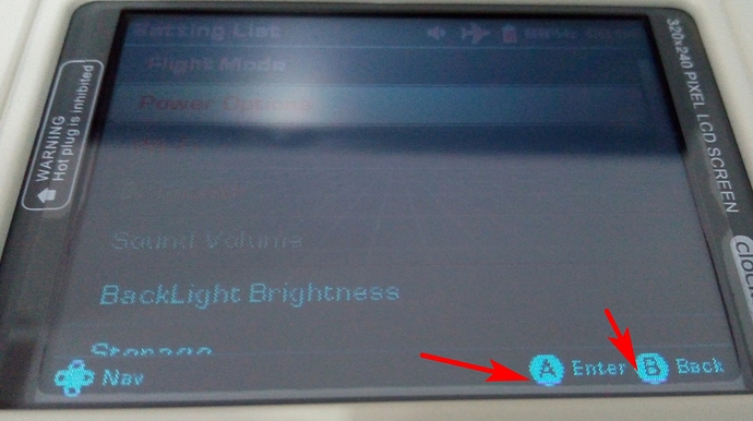

I actually managed to get one of my CPI boards to do what yours has on the bottom footbar. A light line going through the buttons. Pretty much in the same place.
Using the 5.7 kernel, I just did a reboot; without changing the kernel and then the line vanished.
This was a CPI board that would show the line maybe 50% of the time. Not great, but much better than some other people’s result. So far, doing a simple reboot has fixed it every time, although I haven’t done much more besides this, ie I haven’t done any extensive playing after the reboot to see if the problem comes back.
Before people immediately assume that changing to the stock 5.3.6 kernel fixes the problem, try a) a simple reboot while still on 5.7, and b) doing the suggestion suggested a few posts up. I will be looking into it on the weekend when I have some time.
I did do a reboot to try and see if that would help, and it did, but I then let it sit for a few minutes and it progressively got much worse over time. To being unusable. With either the gpu driver or software rendering, it was the same.
