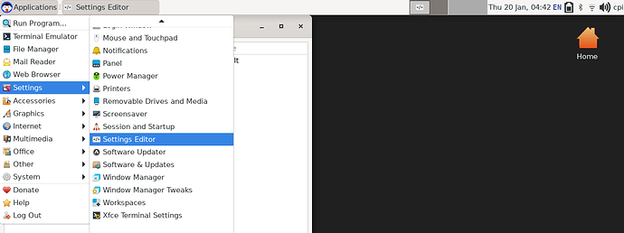

  2. suspend icon/button had disabled/hidden before,here is how to enable them back
    goto Left-top corner,Applications->Settings->Settings Editor
find the xfce4-session ,on the right ,scroll to bottom ,find ShowSuspend,enable it
another suspend icon/button is on the right-top corner, the user menu,it needs editor to edit xfce4 config files manually, file location is: ~/.config/xfce4/xfconf/xfce-perchannel-xml/xfce4-panel.xml
set -suspend to +suspend
after reboot ,suspend icon/button should return back
