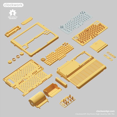

The gameshell had an alternate lego back cover, so I don’t see an alternate larger rear cover being too left of field. Then again, they never made an official light key integrated one. That was s community member.
Definitely something to look into, using the existing 3D files of the chassis.
