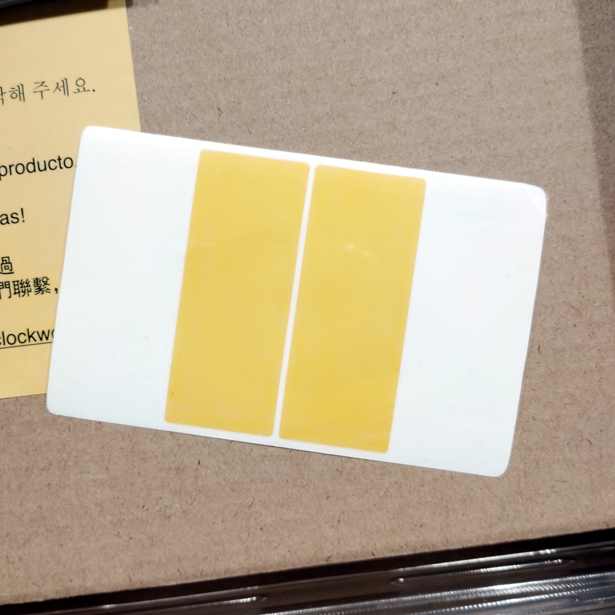

Absolutely… They’re putting tape in the kit now ?!
Yes, it comes with a sheet about the size of a credit card, with four pre-cut adhesive strips on one side and printed instructions on the other. I used the two outer strips, so the two remaining yellow strips can be seen in the picture.
