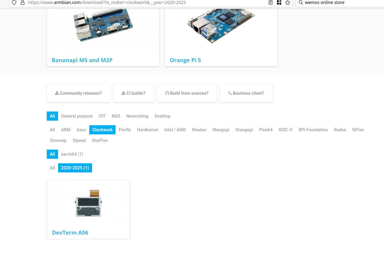

Love the armbian use here. What would be the chances of seeing the gameshell in the download list of armbian website like the devterm ? (see screenshot below) :
