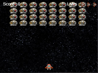

GSPLauncher
GSPLauncher is a phaser.io application that does what’s its name implies. It launches other games (and applications). Basically it can launch any kind of HTML/JS application but currently it is restricted to phaser.io games. This is the main application of the GSP project.
GSPGames
GSPGames is the sibling of GSPLauncher. It contains phaser.io games suitably ported for GameShell. Currently I have “ported” just two small games, Breakout and Invaders as examples and I hope the community here to contribute and port many many phaser.io games for GameShell. A porting guide is published here: https://github.com/pleft/GSP/blob/master/GSPGames/README.md
