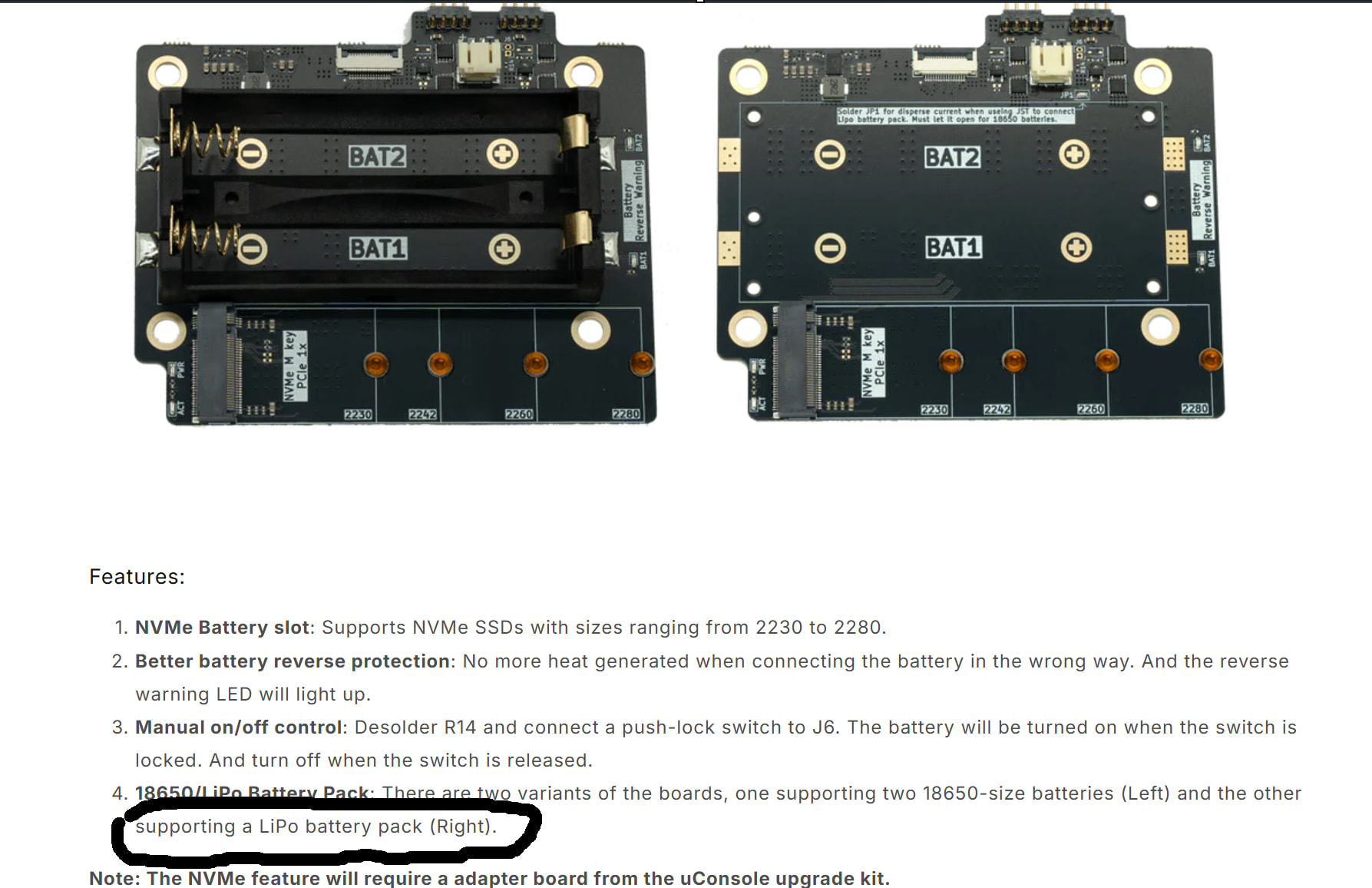

You can’t just buy a battery and only pay attention to its capacity. Batteries have various key characteristics. If these are not specified, don’t buy the battery!
If you buy an unsuitable battery, it’s not the Hacker Gadget Board’s fault.

It would have been nice for him to have published the required battery spec. I looked all over the website and even emailed him asking for the info. I still don’t know if the specs of this battery are compatible.

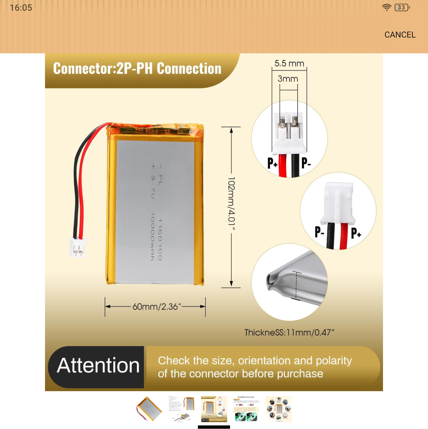

Do you have a recommended source for lipos? Trying to fin units that actually have tech specs on Amazon or Ali Express is almost impossible.

I have no experience with Lipos from Amazon. On AliExpress, you usually find the data under “Specifications” as “discharge current” or “max. operating current,” etc.

We have some really rude people on this chat!!! Let me spell it out for you: the 18650 battery board model is a like-for-like replacement and is designed for basic-level people and for the advanced users among us they provide it without the 18650 holder so you can support your own not supplyer supported battery option for those that like to tinker and 3D print replacement back covers for personal supported projects, it is not for those in the group that don’t understand Lipo tecnology and are a danger to themself and everyone living with them. For the safety of everyone, just unsolder the 18650 bracket from the original battery board and put it onto the one you got without it and be happy with the capacity of two 18650 cells.

Chill out. The picture on hackergadgets store page shows a single large lipo made by the same manufacturer that Davkenrem has nestled in the back of a stock case. He’s not stabbing it with a screwdriver or hooking it up directly to a 5v unregulated supply. There’s no reason to be an ass about it. If you can’t contribute to the conversation in a helpful or at least funny manner, please find something else to do.

Can you tell us where you sourced the lipo you used? Almost none of the 9854102 sized packs I’ve found have any useful specs in the listing.

I bought my 9858110 battery from taobao.com. I haven’t try to source it from the Aliexpress.
