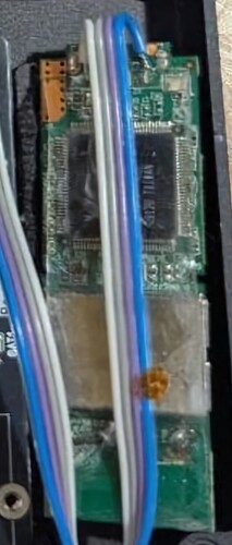

What is the module bottom right ?
It is a 2.4Ghz wifi module, that supports monitor mode. You can (barely) see the coax cable, going under the battery board towards the extra RP-SMA port on the side.
