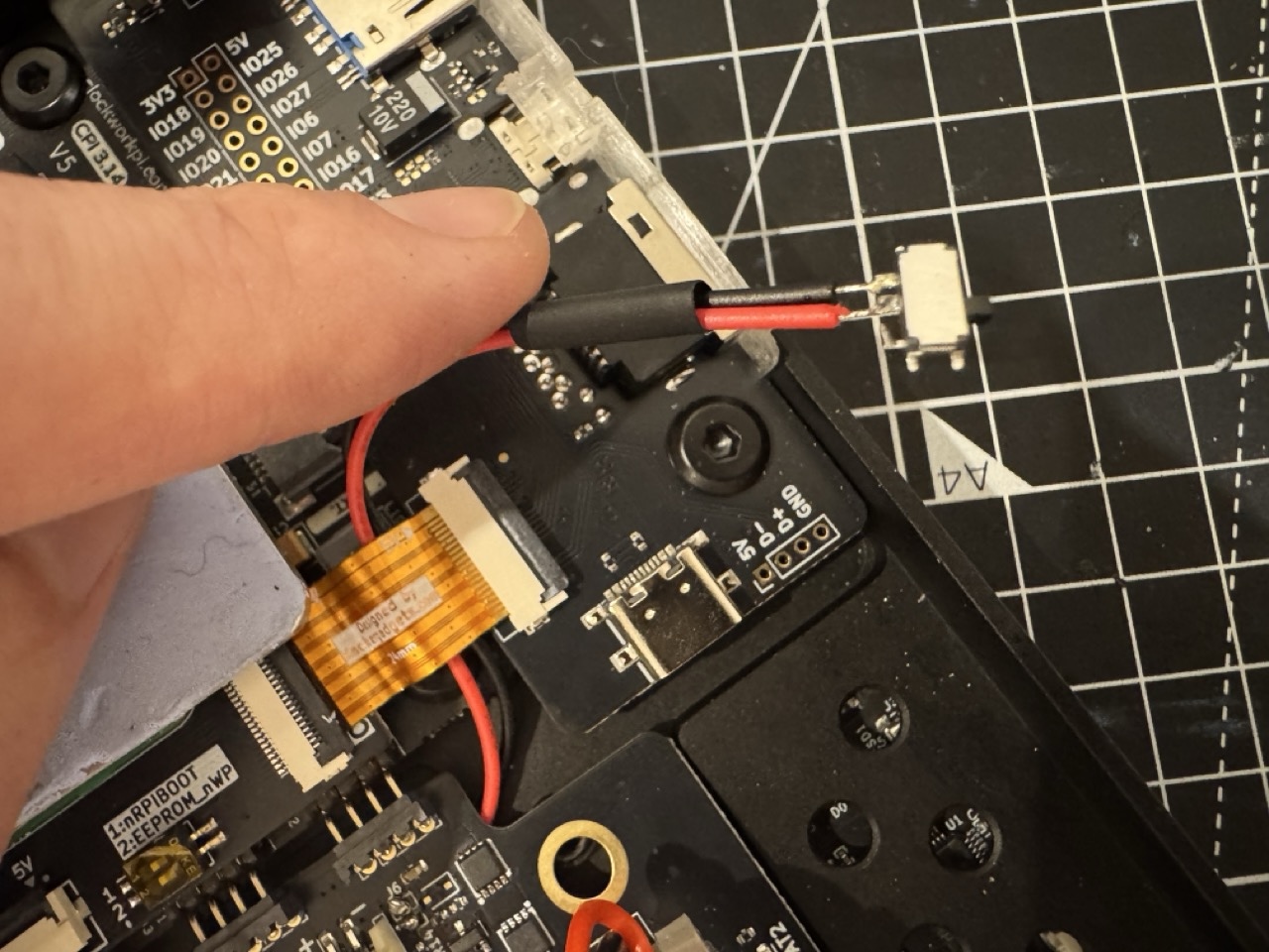

I’ve been working on this mod for the last few days.
It adds a non-destructive reversible power switch using the HackerGadgets NVMe Battery Board - thanks for HG reserving sockets for achieve this!
This is a SMD MSK12C02 switch that sits less disruptively at the side panel. The switch button protrudes about 0.1mm so it’s easily reachable but won’t block other extension connections.
The instruction & guide is available here.

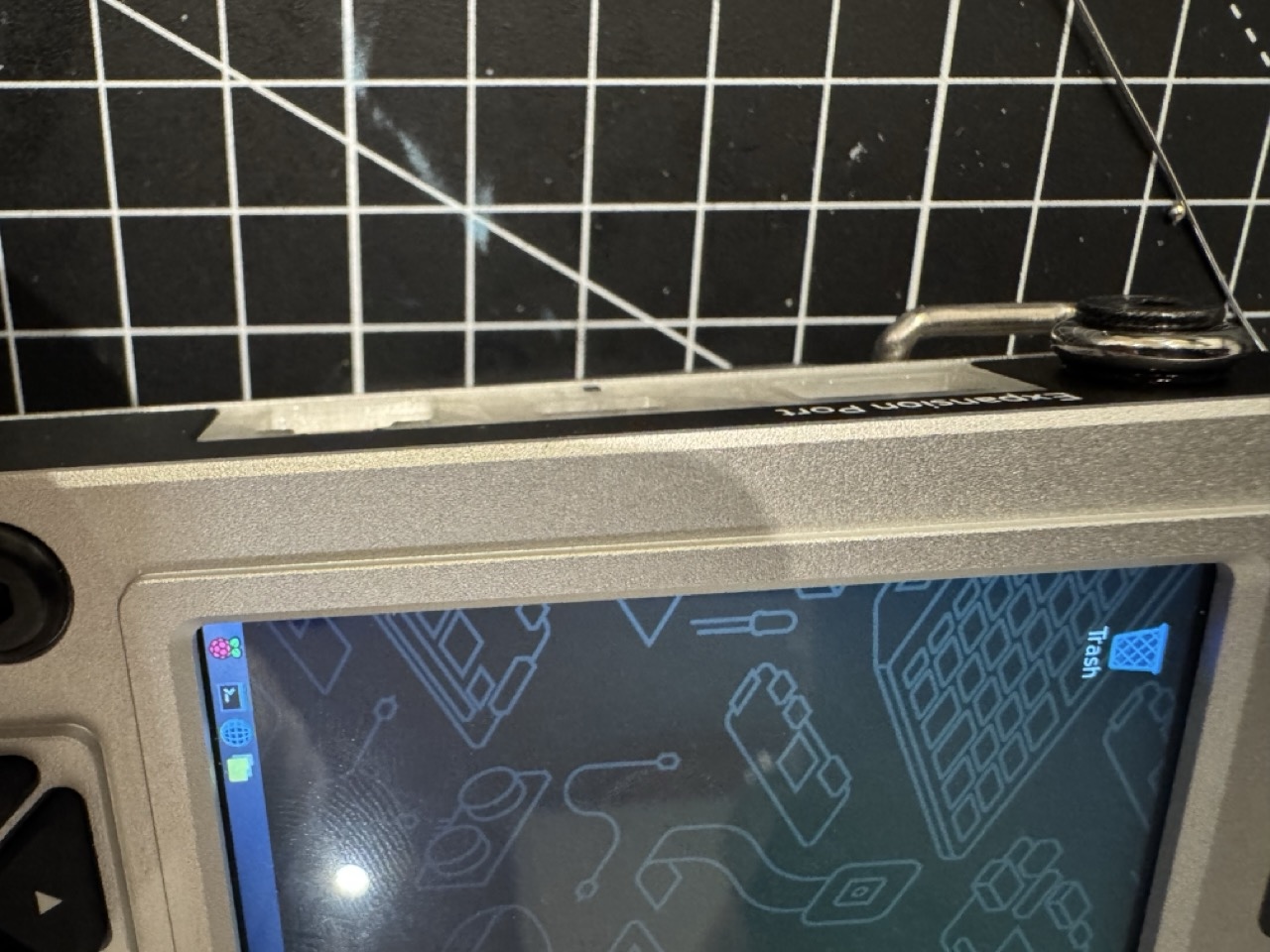

Here is the result:
sit tightly in the side panel
Minimum amount of wiring exposures & space needed.
little black dot is the switch, flip the switch cut off the battery from the JS2 connector

Hello and thank you i now have an on/off switch. Boy that R16 was hard to remove.
It does need some craftsmanship! :+1:
Try this fix Finally: hard reset button fix
A quick note, the switch also turns off NVMe on the HackerGadget battery board.
