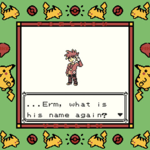

I was playing Pokémon Yellow on the GameShell using javelinface’s custom DEOT image (Custom D.E.O.T. V2.0+/Clockwork OS v0.5 image - With customised DEOT interface, Kernel 5.4.24, Optional 1400MHz OC, Debian 10 Buster, Retroarch 1.8.5, Mupen64+ plus more! (Current build: 200328)), but when I loaded the game instead of being in a square aspect ratio, it’s stretched across the screen. Honestly, this just makes the game look crappy and low quality. Here are some screenshots I took:
Pokemon Yellow-200407-042506 Pokemon Yellow-200407-042438
