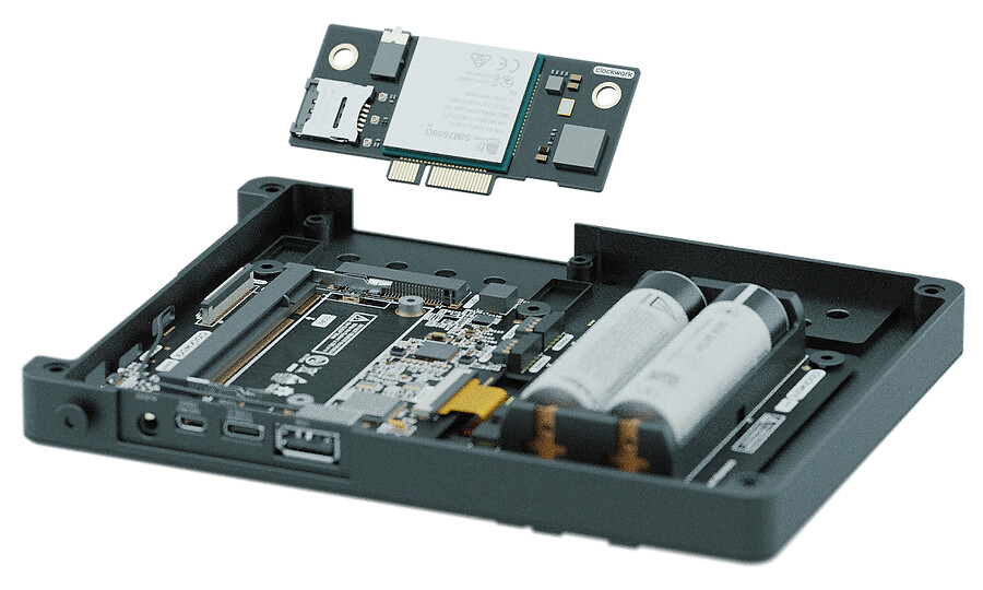

I am not seeing any passive or active cooling at all on this.
I wonder if I am missing something, and how thermal throttling is going to be handled.
From the store page:
We are pleased to introduce all-metal construction that will bring beautiful texture and solidity while improving the efficiency of passive heat dissipation.
So im assuming some thermal pads will be used to fill the gap between the SOC and the case.
Buy your own thermal pads. And, thermal throttling? Definitely not on the CM4 unless you’re overclocking it, idk about the A06 or A04, but I doubt it.

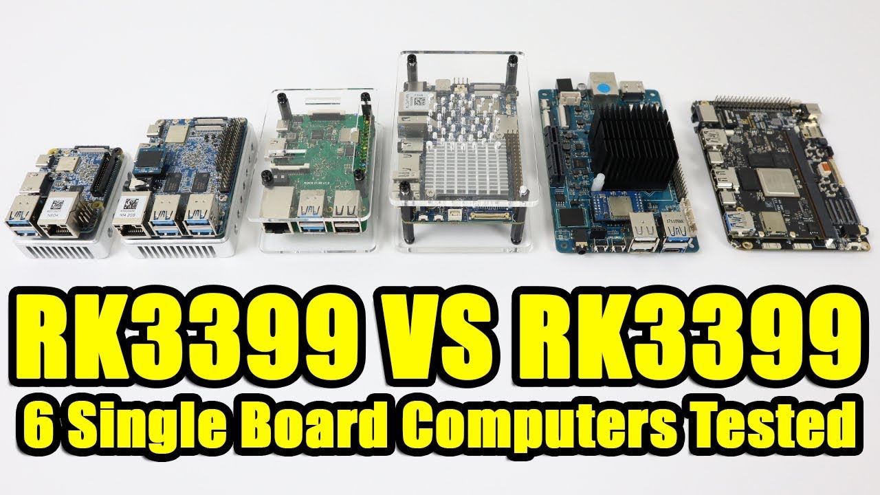

sidenote: how does the A06’s performance compare to the rpi4?
The A-06 core uses the RK3399 chip, which was RockChips flagship SBC CPU 4 years ago. And the RPi 4 came out around the same time as it. So, age wise they’re comparable. Powerwise, its pretty much a draw.
Geekbench 4 (not Geekbench 5) scores vary due to overclocking or underclocking. (the RPi 4 uses the same chip as the CM4 to be clear)
https://browser.geekbench.com/v4/cpu/search?utf8=âś“&q=Raspberry+Pi
ETA Prime testing multiple RK3399 SBC’s on the same Geekbench 4 tests
So as you can see from the single and multicore scores, the single core score is the same obviously because both have A72 cores, but the RK3399 AKA A-06 can get a somewhat higher multicore score with overclocking than the CM4 can with overclocking. Now, that’s the CPU scores. I don’t really know about the GPU scores. Or how other parts like the RAM compare.

Just bought these 120mm x 20mm pack of 4 pads, Artic brand. When the uConsole arrives I’ll let you know how well they work. I think the thermal mass of the case will be enough to cool the CM4, as long as the CM4 isn’t running at max power for 5 or more minutes. I will keep you guys updated, maybe it’ll make the back uncomfortably hot or maybe not.
you know ive just realized, you could easily 3D print out a custom backplate for the case with a hole and holder for a fan. Now, powering that fan would be the issue. Maybe a EE or someone good at soldering can figure out where you can solder the power and ground cables for the fan onto to get enough power for it.
