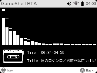

1.2 update log
  • Fix screen dimming bug in Performance mode
  • Add a new audio spectrum in Music Player
