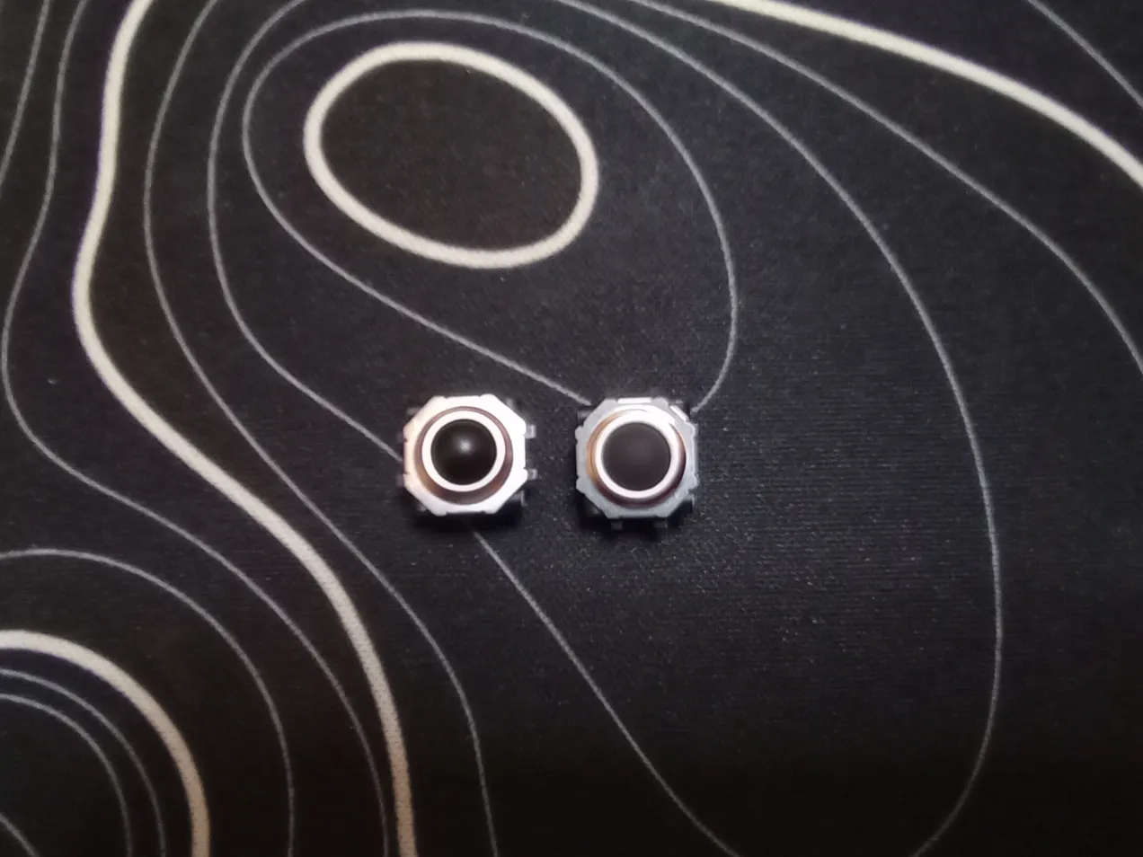

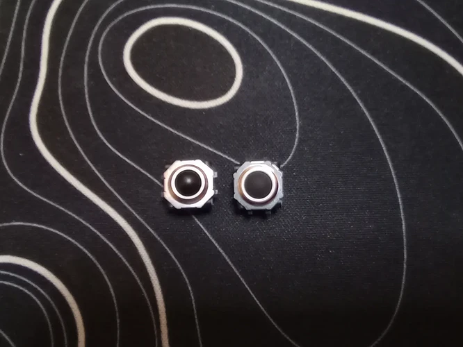

There is a visual difference as well.
Stock on the left / EVQWJN007 on the right.
The stock one is smooth and rolls sometimes without it registering by the keyboard.
The EVQWJN007 is textured and the ball it like .5mm bigger, it’s not a loose in the housing.
