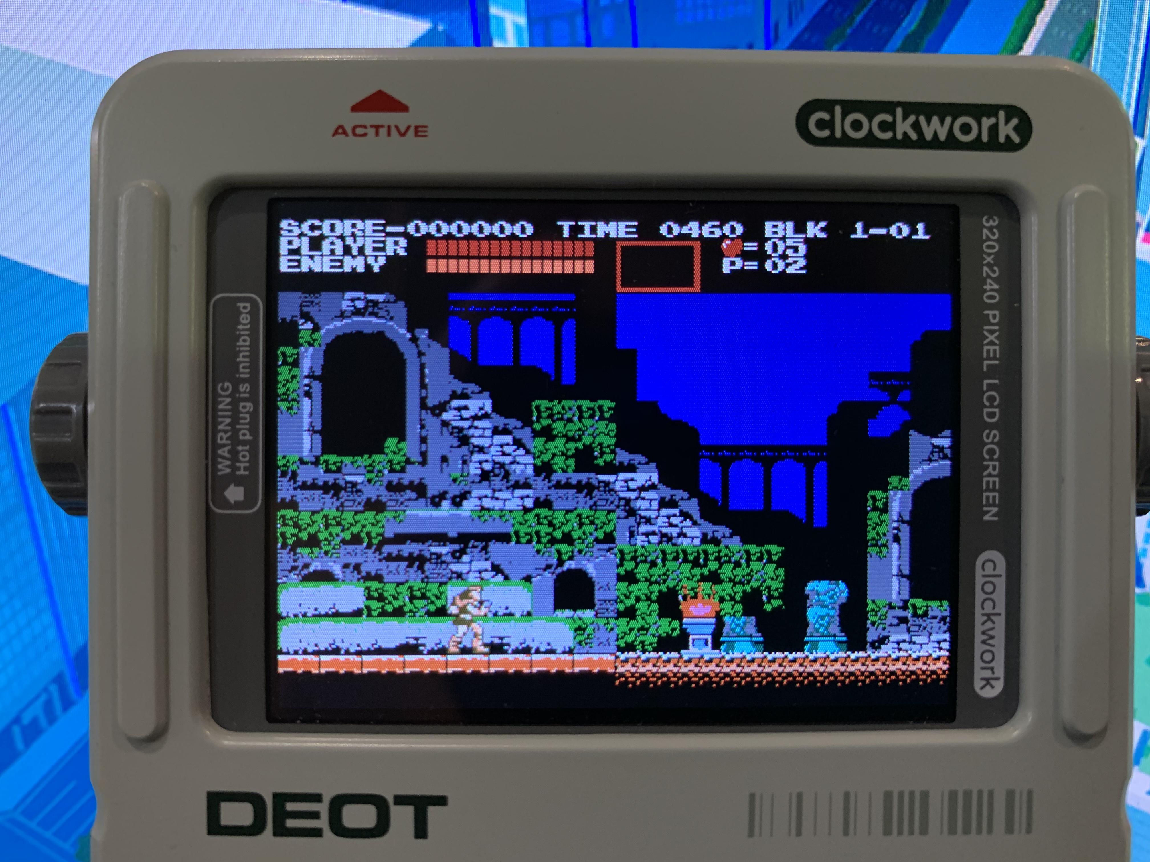

The next three images show the differences, emulating NES games, given their lower resolution.
Zoom in closely to the text at the top. You can see how the configuration of the LCD isn’t technically parallels rows and columns of pixels; but more of a diamond formation; much like an old CRT would have had. I am actually a huge fan of this display, despite what many may say as if gives a hardware solution to having what can seen to be close to a CRT accurate solution without having to waste resources on shaders and/or filters.
The first image shows hq2x filtering. You can see how it has an interpolated quasi haze to the edges of jagged corners, which although nice comes at a huge performance hit.
The second shows no filters at all. On the NES, the resolution is 246x240, meaning that although it won’t be an integer multiple of the Gameshell’s 320x240 screen, it is a lot closer than that of the GBA. There is still some jaggedness due to scaling, but nowhere near as bad as that seen above.
The third image shows bilinear filtering. It is again a lot blurrier overall, but interpolates the scaling to allow for a much more normalised smoother image, without the huge performance hit experienced with the hq2x filter.
