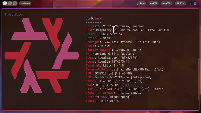

It’s been an interesting few months, with crashed street bob and hospital bills and …
but, let’s say… got CM4/5 working again (thanks again Rex). If there is still interest, I can share the CM4 (can boot both CM4/CM5) or dedicated CM5 text-based image to test.
I will commit the flake to the branch of oom-hardware repo as soon as I do some cleanups and setup some binary caches ((-;
This awesome, thanks for sorting out the upgrade to 25.11! I am using your flake as a base to build my system for the uConsole.
