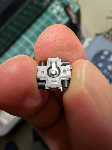

Ok, I've joined the AliEx trackball lottery :) Is there a correct orientation for these?
I have a bag of 5 shiny new trackballs from AliExpress and am going to try them because the one that came with the uConsole doesn’t perform well at all.
Looking at the pic, I can’t help wondering if there’s an orientation for these and if I have fitted mine the wrong way, hence the rubbish performance.
So, is there a correct direction for the little tab in the middle to point? Is there anything I can do with these to improve the way they move the on-screen pointer?
That silver leg in the middle points down towards the keyboard.
Thanks Rex!!! What’s the betting I set it pointing up when I assembled the uConsole?? :rofl:
Up will work also, I just always say down. You just don’t want it left or right, then things won’t work right.
I just rotated it down and it’s still rubbish :blush: I’ll try the AliEx ones to see if they are any better. WD40 might be in order for the rollers too.
I’ve had bad luck myself with various trackballs but the ones I’ve ordered off AliExpress have always been good.
I can see why it won’t work right if you set it left but if you set it right, it’s not right, right? :wink:
And to think, I was already confused! :rofl:
There’s two half millimeter posts on the left and right that notch into a hole on each side of the keyboard.
Progress. I removed the trackball, dunked it in 99.9% IPA (not Indian Pale Ale, which would be a waste of good beer!), swished (the scientific method) it around for a minute, dried it, sprayed the whole thing with WD40, removed the excess and re-fitted it. It’s a LOT better now and actually useable as a trackball. Yay.
