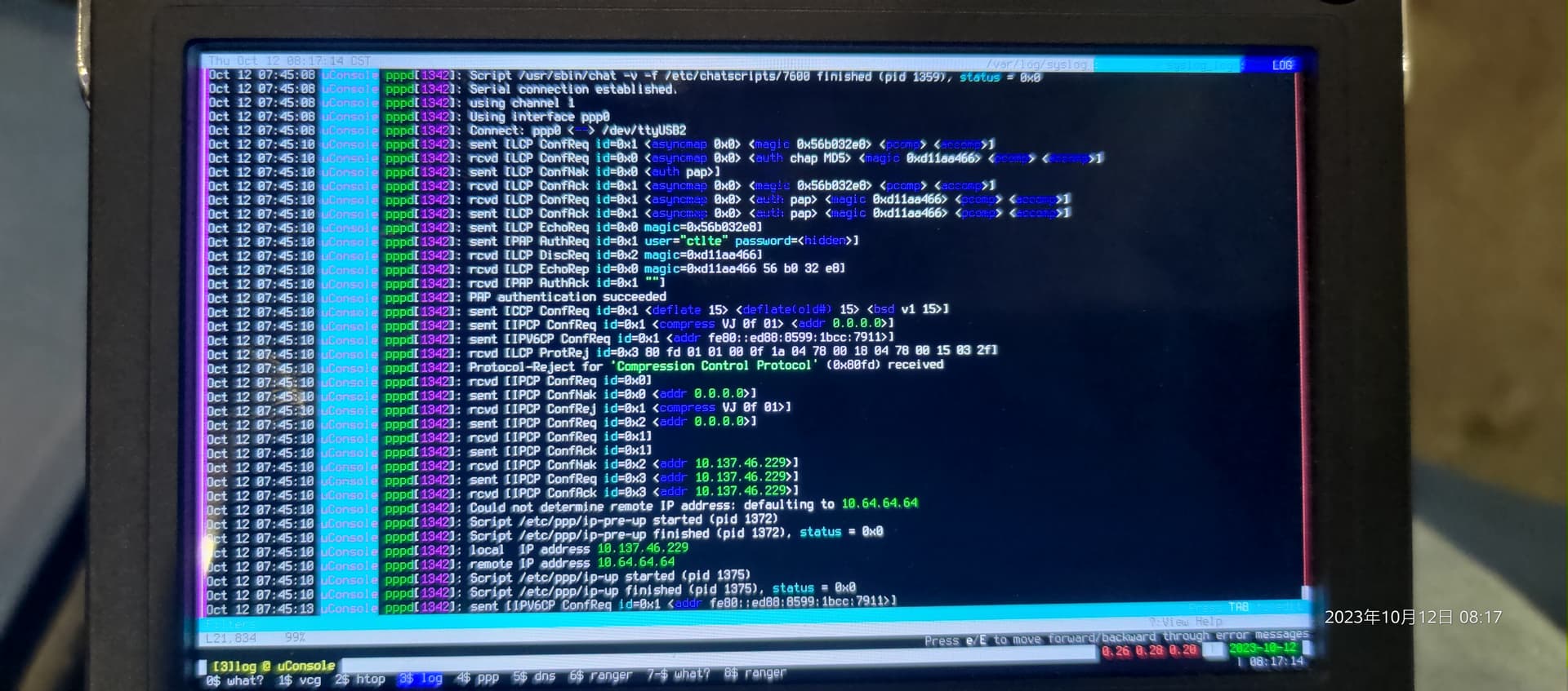

well as i don’t have network manager running i seem to have run into the issue described here
Unable to connect 4g (Network Manager not running) - uConsole - clockworkpi
basically i have no modem, and usb0 when i ip a, the SIM is reporting ok

One of two things fixed my issue detecting the modem
  1. Switching back to network manager
  2. restarting ModemManager after running the modem enable command
Still havent managed to get the SIM to activate… not sure if it my APN settings or what…

yes indeed, i have read the modem manager docs and installed the gui sudo apt install modem-manager-gui - the issue is the SIM never registers on the network - my issue isn’t how to use modem manager - its if the APN settings given by the network provider work with it… i suspect there is something missing… i may need to put the SIM in a real phone first…
also note those instructions are very misleading, nothing needs to be installed with snap and modem-manager is already installed on the device image
yea, i mean… was hoping you would run
sudo modem-manager.mmcli -m 0
and look at what it says about your sim… if its locked… got any signal…
Sorry, i missed you saying you are using the included image…
If you tried the string and it fails… i would call your cell provider and make sure they allow your device to be provisions on their network… they may have to pass it to engineering and request a device exemption… in the US… verizon didn’t let me… so i switched to t-mobile… but that was a linux phone… not a 4g modem…
good luck though.
i posted this a couple of days ago, thought it redundant to post the same detail here… i think it will have the details you were looking for (aka i already read the manuals 3 days ago :stuck_out_tongue: )
Help with 4G card - can’t get any modem to show up - uConsole - clockworkpi
I even edited the enable script to restart the ModemManager service as that is needed EVERY time and not documented…
Even a simple connect is not working - so its either the APN details are wrong or they are only allowing iOS and Android devices like you say.
