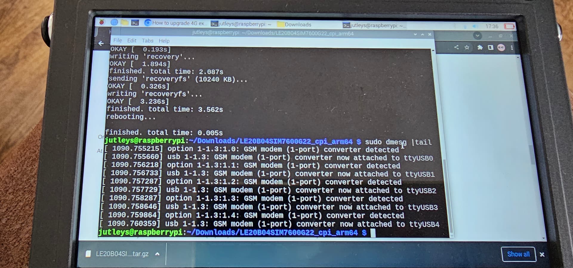

Well i decided to flash the 9011 firmware as 4g is so much esier to use here are my outputs i guess it was a sucess.
