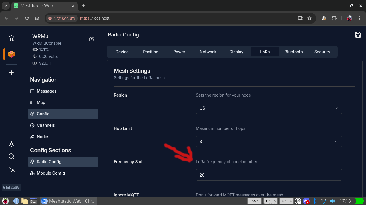

Ok… the dust has settled, everything is operational (it seems), but still have an issue. Likely more of a meshtastic one, but thought I would try here first.
I have two other meshtastic devices… the Heltec V3 and the sensecap T1000E. When I fire up mestastic on the uConn, it is not picking up those nodes.
Any idea’s beside operator error?!
Hmm, sounds like you have more experience than me with Meshtastic already. So i guess you already confirmed the uConsole is on the same region/frequency as the other devices?
check region, and channel settings on the uconsole and check that the other nodes are also up to date.
All settings are in place correctly and mimics my other nodes.
Region: US
Channel: LongFast
Role: Client
All nodes running: V2.6.11
make sure this is set to 20. if you’re in the US.
It was not ! I can now see 2 of my 3 other nodes that are live from UConn. Thanks!
