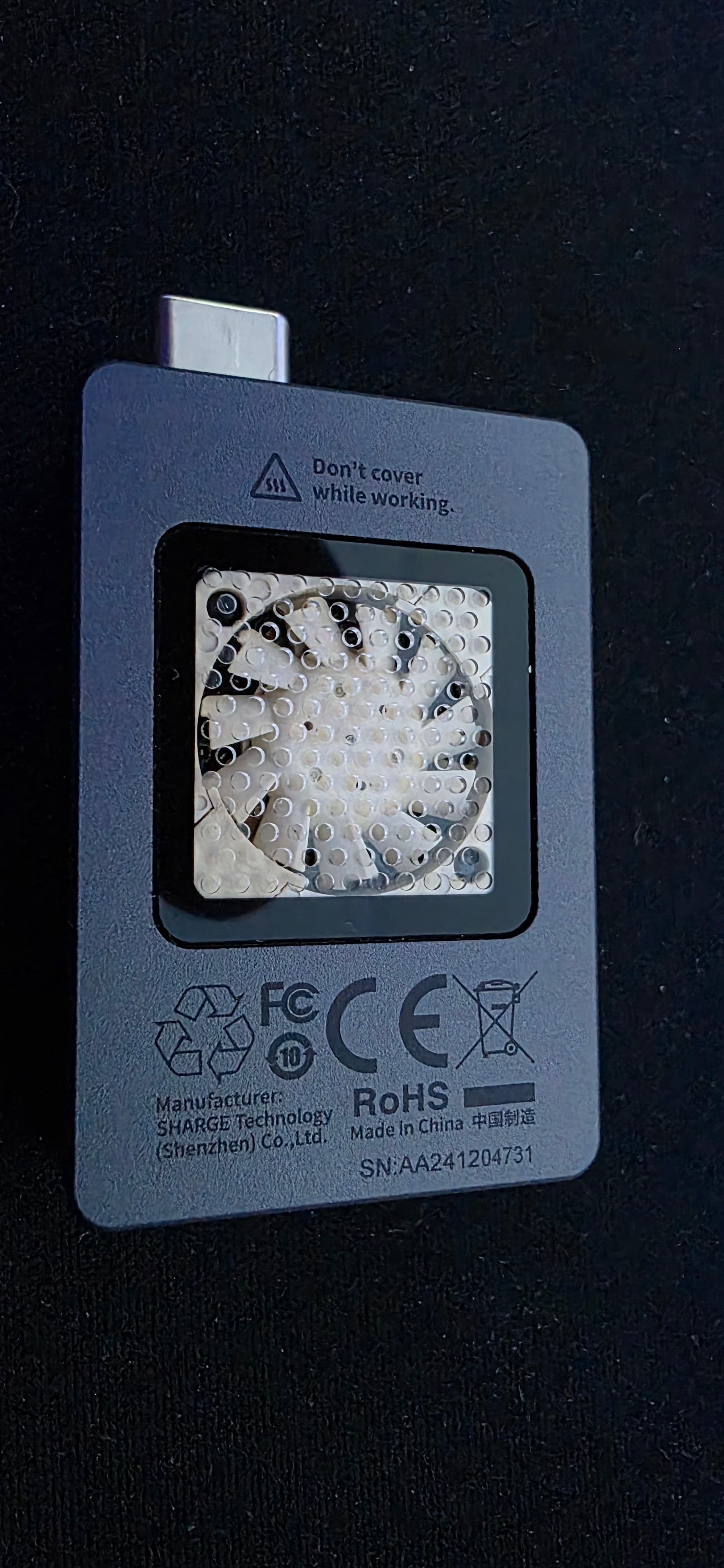

Can we use a 2230 ssd drive on the internal type c. I am thinking of power draw would be high. But it has a self cooling fan built in.

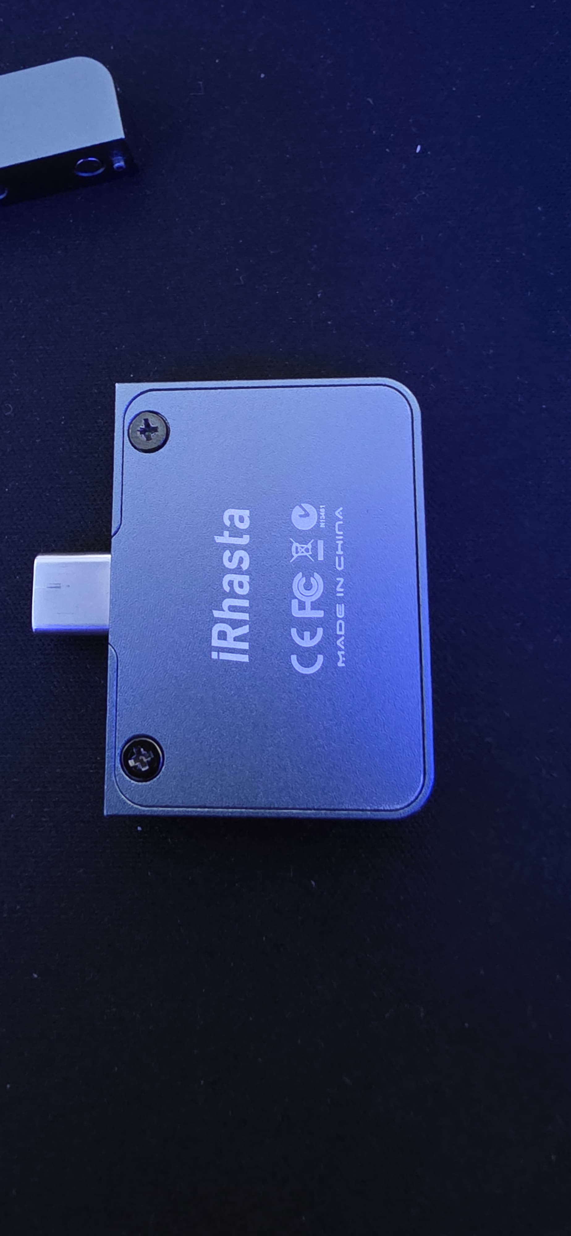

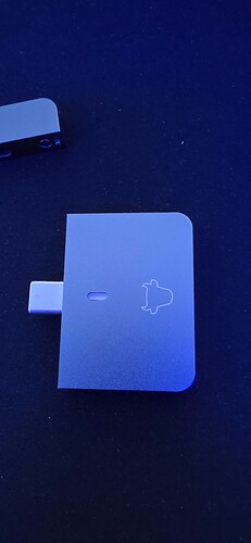

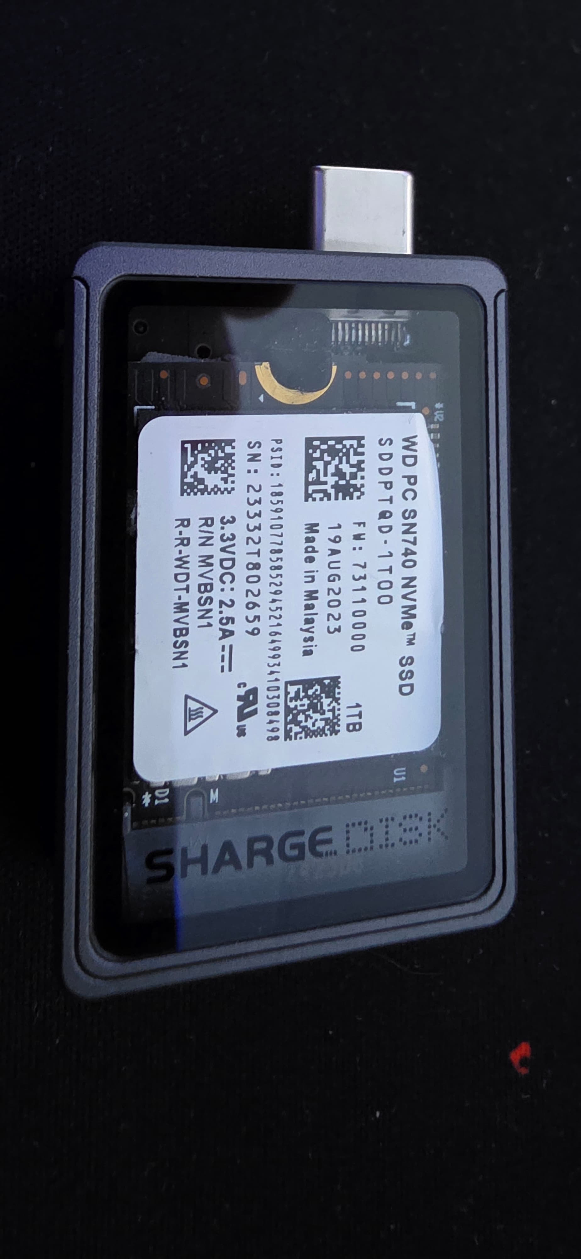

I also have this one again 2230 ssd
It’s still only USB-2 so you might as well just use a USB memory stick.

The internal USB-C port and the pin header not have a current limit switch; the VBUS is directly connected to 5V, so it may work, but the speed is limited to 480mb/s due to the maximum speed of USB 2.0.

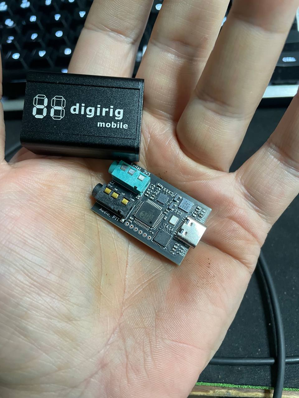

But the internal usb port was really nice because now i realised i can also mount a digirig on the inside and just drill a couple of holes for the connectors and the uconsole becomes a really competent little qrp computer for digital modes.
