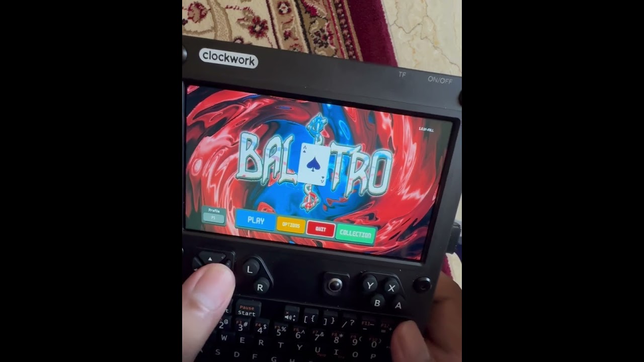

I had been streaming Balatro from my computer via Moonlight when I realized… it can probably run natively on my uConsole. Sure enough, there are posts on how to port the poker roguelite to ARM Linux-powered retro gaming handhelds. It will basically run on anything that can run the Love2D engine.
All you need to do is copy and unzip the Balatro.love file from your installation, add an entry for Linux somewhere along line 50 of globals.lua as follows:

Then rezip the files (there should be a bunch of files in the main directory of the archive, not a single folder), rename the .zip file to Balatro.love, and then run the game using love /path/to/your/file/Balatro.love
Everything works! Here it is running on my system in Wayland. The game plays, I could drag my save files over to .local/share/love/Balatro, and I’m able to unlock unlockables through play.
