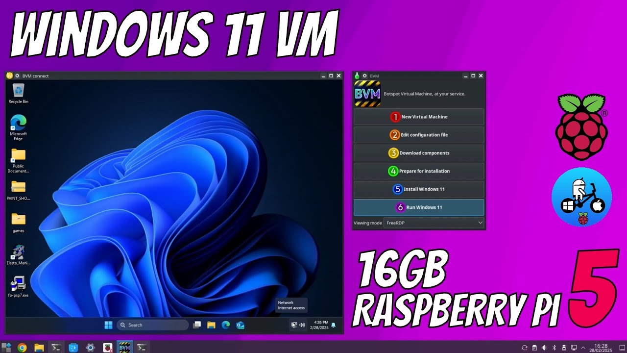

Here, a just release video for your enjoyment.
I stand corrected, that works much better then I anticipated. A lot probably has to do with it running on the pi5 / CM5, but still, nice!

BVM is going, but VERY slow on an SD card. After an hour and fifteen minutes, I’m downloading virtio drivers with a few steps left to go.
[edit] just failed… Need a larger card! Do not try this unless you have larger than 64GB, it tries to make a 40GB space for Windows, and uses a pile getting things ready. My 64GB is not big enough.
I’ll have to put my 256 card back in and see if it will go, but getting late and not sure how much more time I can give it tonight.
i just finished installing windows on my 8gb CM4 using BVM. It took over 4 hours and windows runs slowly, but it works.

Wow, thanks for posting that link! I installed bvm earlier today on my Devterm (CM4, 8GB), and it’s surprisingly functional. It’s slow, but I expected it to be a lot slower. Though it was a different device, I played around with WoR on the Pi400 a year or two ago, and I don’t remember it being as fast as this thing is. I don’t have a CM5 to try or compare, but I’m guessing it might be close to full speed on one of those. I have a ridiculous 400GB card in my Devterm, so space wasn’t an issue, and I was thinking I might start over from scratch anyway since I’ve got one of your first Bookworm OS builds running on it. I could probably just update, but I’ve done plenty of weird things with it kind of figuring I’d install something more stable later on.
Anyhow, bvm is kind of magical. Probably more of a tech demo for CM4.
Also, @Greg_E, I think you had mentioned you were looking to view video streams. When I was reading up on bvm before installing it, they mentioned there was no accelerated video. So I’m guessing watching a video stream would be even more painful.
When I was playing with this, I wasn’t directly using the Devterm. I VNC’d into it. So my display updates were probably taking a bit of a hit from that, but it still seemed fast enough to use with some patience. I didn’t try to install anything serious on it though.Definitely wouldn’t want to play games on it on the CM4, and probably not on a CM5 either. Still, kinda cool, and maybe useful for certain applications that don’t require fast updates or interactions, and don’t run via Wine of Box86, etc.
Hardware support would be tricky too. While I didn’t try it with anything, it looked like it could support USB passthrough for devices. But I don’t think bluetooth or (direct) wifi is an option. It has internet access through the virtual ethernet stuff it sets up, but I don’t think there’s a way to see other machines on the host machine’s LAN, etc. Direct IP access would work though.
