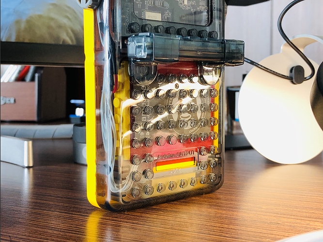

So after I measured the size of the original battery box (remember that it is 70 x 50 x 10mm), I decided to order a suitable battery from internet. In the end, I ordered a 3.8V 4200mah 16Wh battery with size of 66 x 45 x 8.8mm with customized ZH/JST 1.5mm 2Pin connector (male). Then I used the original battery box (transparent piece) as a limiter installed this battery。

Wow that looks pretty cool, have you already printed it? Could you maybe post a step by step guide on the process (which parts are needed, how are they assembled)?
I would love to have a longer battery life with my GS.
