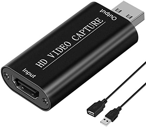

The easiest way would be to get a USB HDMI adapter and then just use the Gameshell’s video output as a USB video-in on your PC. Though I’ve never used the Gameshell as input, I got one of these and it worked fine for streaming from an XBOX 360. As long as you can produce HDMI video output, you can stream anything this way:

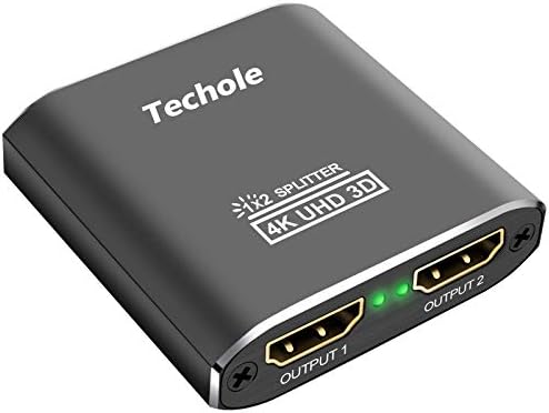

For playing games, I’d recommend getting an HDMI splitter as well. Otherwise, the only way to see your video output will be through your PC’s streaming software, and there’s a small delay. For gaming, that delay is noticeable and can be annoying since it’s like having a slightly laggy controller. With a splitter you can have the Gameshell (or whatever device) hooked up simultaneously to the adapter for streaming and a monitor for playing. This splitter worked for me:

I already thought about that, but unfortunately I still got a first generation Gameshell without hdmi out -_-
