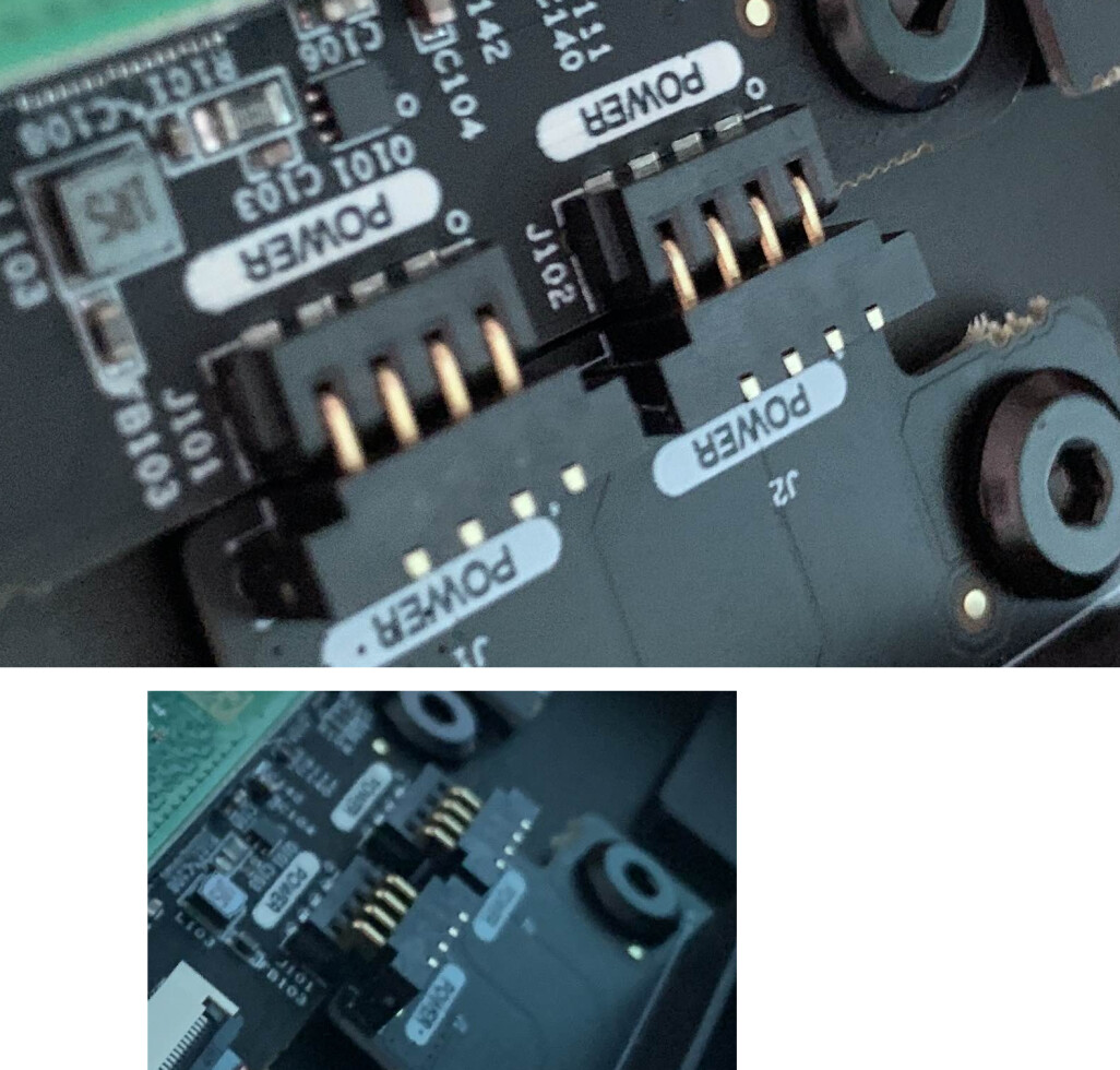

is your battery board connected properly?
how long do the batteries last once you remove the charger?
Thanks for quick reply. I think it’s batteries fault. uConsole shows 4-5 h of working hours, but reality is that under load it’s just couple of minutes. That also must be the reason of not starting on batteries. Ordered new ones.
