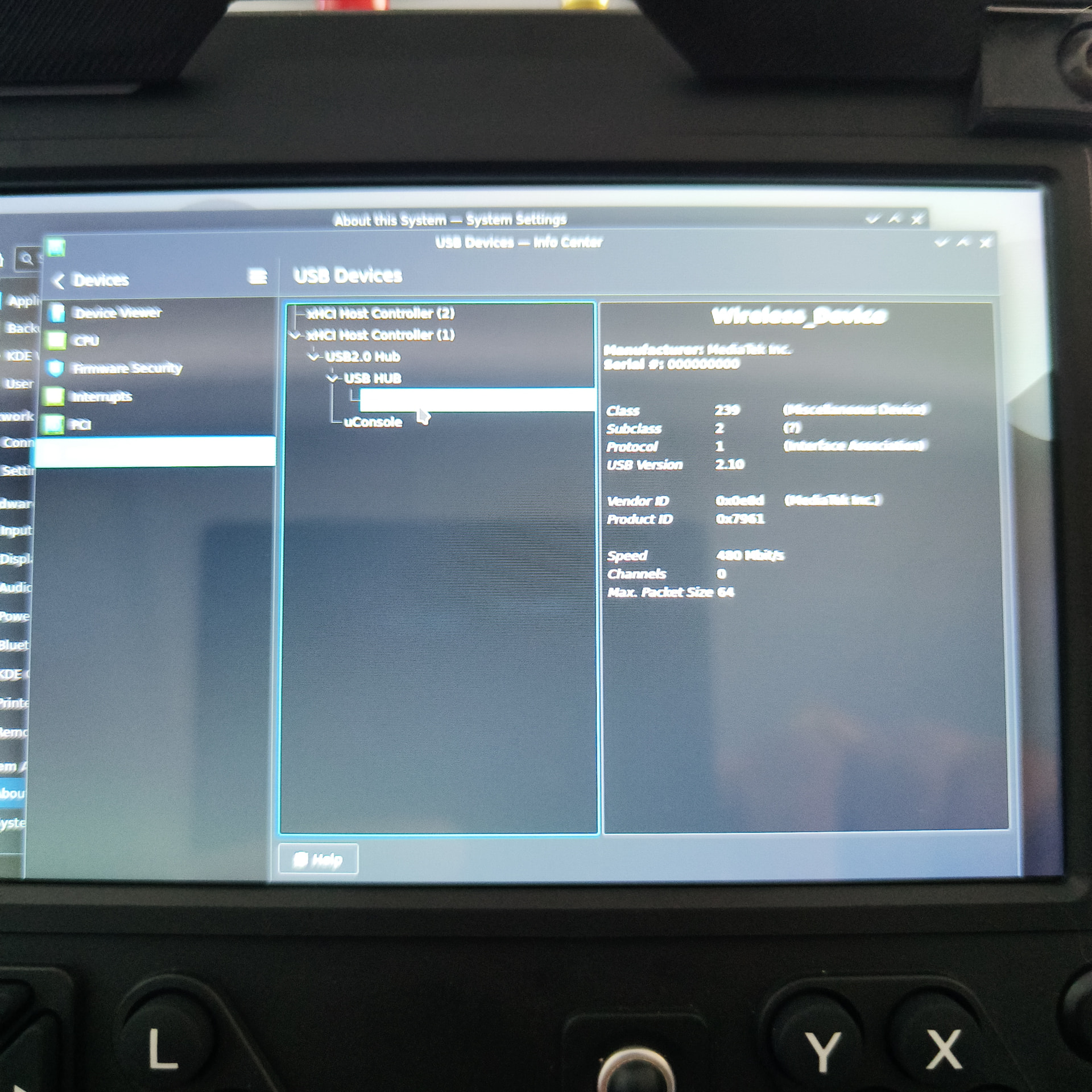

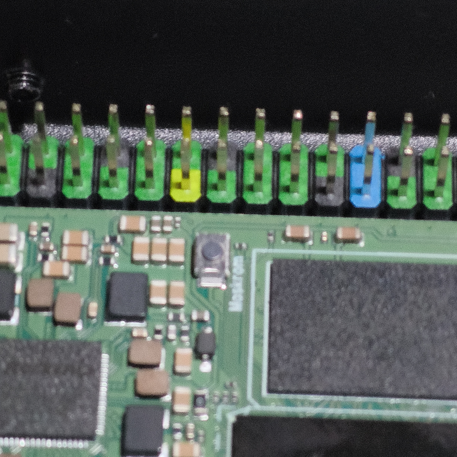

So first flashing the radxa rex image for the Uconsole to the emmc using the below method. It wrote the image successfully, I am using rkDevTool v2.86 and for the carrier board I am using a cm4 io base box see pics. Please note your need to put your CM5 board into mask mode by pressing the little button see pics. Then plug power in you will see Found One MASK ROM Device this should be the internal emmc see pic below.

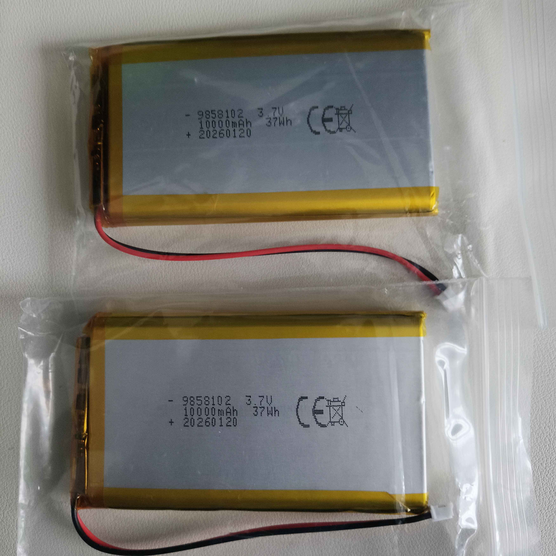

I know the Radxa CM5 is a power hungry beast so i am looking at ways to power it theres two options below. First option is to use x2 10,000 mAh batteries setuup with the adapter from @lululvlv which supports dual Lipo batteries but now sure how this will work with 20,000 Mah lol. The second option is to use @lululvlv new 18650 x3 battery mod. Hopefully one of these options will power my Radxa CM5 soon
