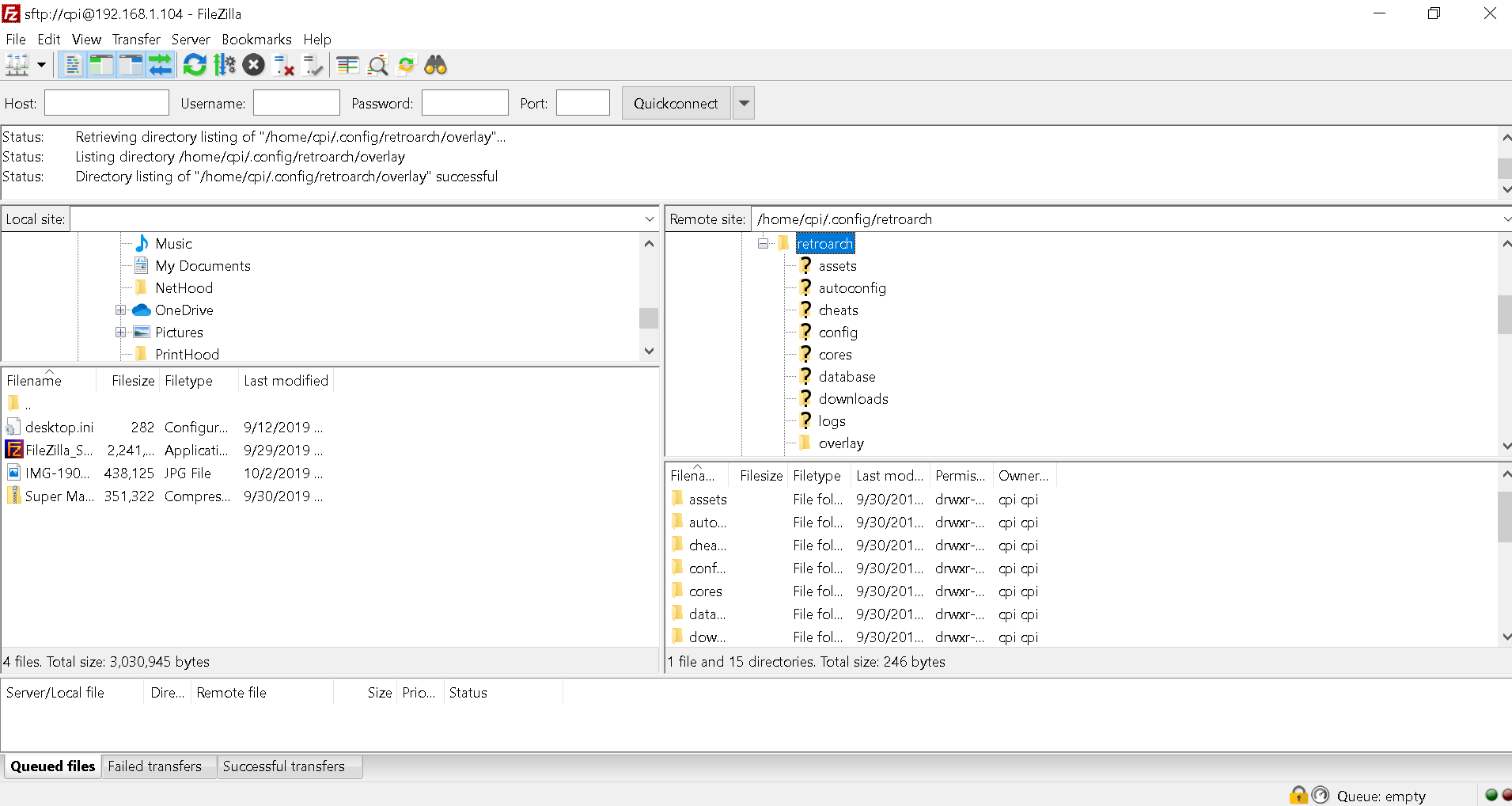

It’s probably the config that’s causing this. There should be a backup file in the RetroArch folder, so you have to SSH there and replace the broken one.
can you see the file named retroarch.cfg.bak or just download from
https://github.com/clockworkpi/GameShellDocs/blob/master/retroarch.cfg and scp to
~/.config/retroarch/

I’m not sure where the retroarch.cfg.bak is
As guu wrote, it should be under ~/.config/retroarch.
No, it should be right in the RetroArch folder, not in a sub-folder.
the full path is /home/cpi/.config/retroarch
~/.config/retroarch equals /home/cpi/.config/retroarch
It was already named retroarch.cfg.
