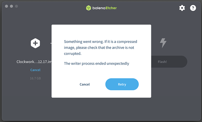

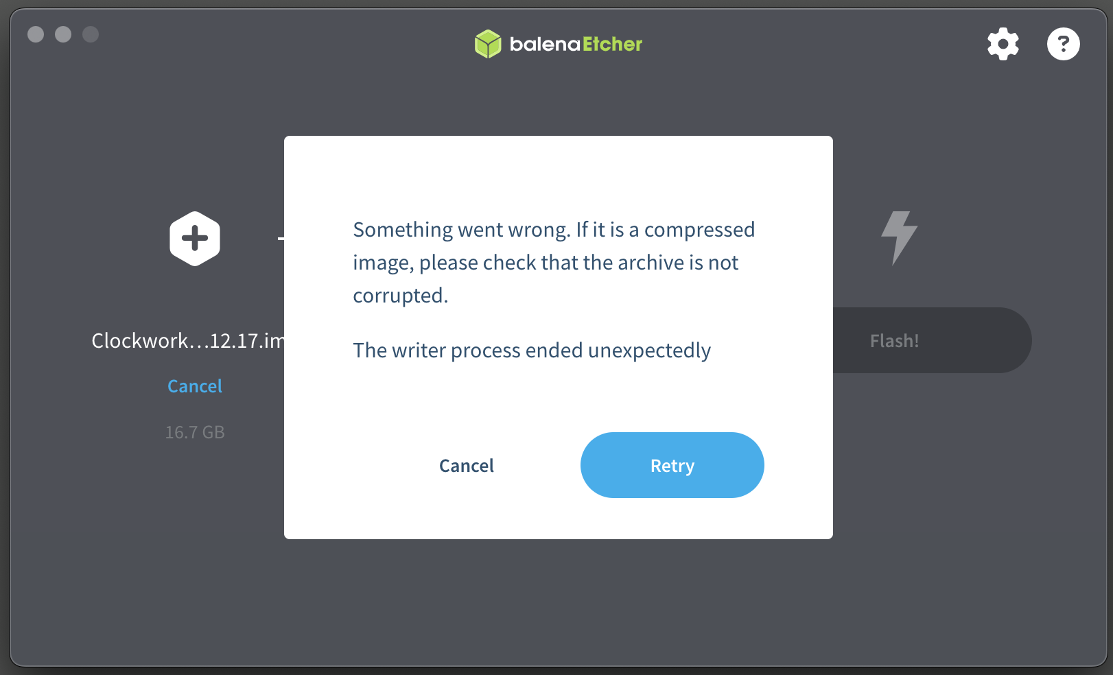

Thanks! I’m using Sandisk 128Gb now, but I’ve flawlessly flashed the regular ClockworkOS image both on Sandisk and Kingston 256 Endurance. The problem seems a corrupted download, but having the same error both from MEGA and GDrive folders it’s a bit odd. Am I missing some steps?
Hum… have you tried with rpi-imager? I find it effective and it checks the burn. You just have to uncheck “apply presets” for everything to work.
I’m giving a shot. Keep you posted, thank you!
I have had no problems with RaspberryPi Imager. Don’t customize install and it will work.
I was getting the same error with etcher but pi imager works every time with any sd card.
