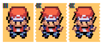

It had a bad time because of the staggered pixels. I’ve crafted this cute image to illustrate the concept as clearly as I can:
staggered
Think each pixel (which in this example is 6x, integer scaling FTW!) is actually a real 1:1 screen pixel.
First image: aligned pixels, the good stuff.
Second image: staggered pixels. But wait, there’s more!
Third image: staggered pixels approximated (by hand) to the real-life result. There’s contamination from surrounding pixels (think “light leakage”); I only retouched the black pixels to illustrate it but it happens everywhere, lighter pixels contaminate darker ones. It results in pixels looking round-ish, dirty, fuzzy. If this happens at 1x, imagine a 2x zoom. FUGLY. THIS is what gives me the creeps. If on top of a 2x staggered zoom you put a bilinear filter you could as well put a drill through my brain, that would be less painful (remember the brain cells by themselves cannot feel pain, it’s the rest of your body that hurts and your brain tells you what hurts. Doh, enough biology).
