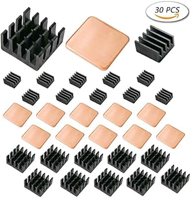

I just used thin copper heat sinks i got off amazon it gets hot but never overheats on me. Maybe it will help for next time.

Thanks for all the replies guys. I think I’ll definitely be getting some of those small heat sinks. Those look perfect. And backing up my sd card just to be safe lol. A quick update before I have to head back to work, i did get it to boot again without the battery. Then later at work with the battery. But until this morning it would load to a blank screen until i pressed a button. And if i didn’t press anything it would go back to a loading screen and then turn itself off. I’ve noticed that a significant amount of my heat is coming off of the small silver chip labeled AP6212. After some googling i found that its for the bluetooth and wifi. Is there a way to turn those both off when I’m not using them??

i’ve seen those kits around but they say that the material of the flat heatsink is brass not copper and the adhesive material (tape) is not that great for heat transfer. Have you done any measurements with these on and off? Can you also link the direct amazon item. It might be different from the one I’ve found.
Even if that heatsink was copper and the tape was doing its job I don’t see how this could actually help. The heatsink is totally flat which means that the thermal energy will not dissipate fast enough. On top of that the surface of the heatsink is still covered with plastic from the casing (i am guessing it almost touches it) , leaving zero space for air to do its job. To my understanding this solution will only delay the inevitable for a while longer. Heat will still build up after it spreads to the heatsink and eventually will become equal with the heat produced by chip and rise from there on.
i think that the best solution would be to have a custom build heatsink that drives the heat with a pipe or ribbon-like surface (or two) at the bottom of the Gameshell behind the speaker, not sure how its gonna fit though :slight_smile:
Did you add any kapton tape? or did you just stick the copper on?
Add a nice thin layer of silver paste under the heat sink that should help.
