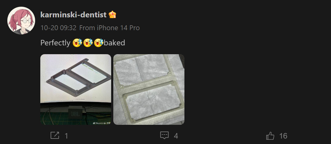

https://weibo.com/2169039837/NoMsTEWDm
someone made a custom back shell.

Found this in other thread. Will try to print next week.
3D models released, back cover could be printed and modified now.
