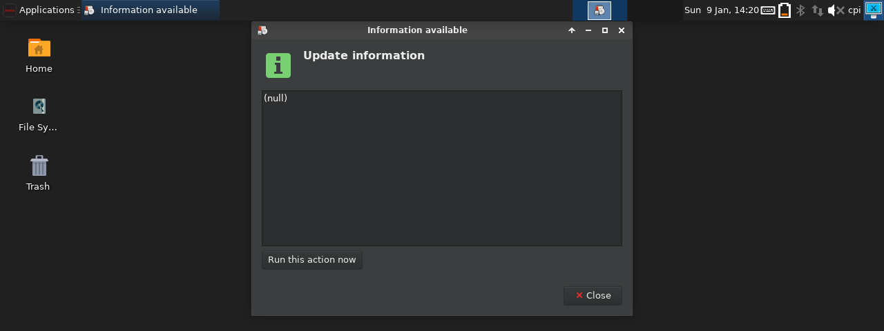

After login, a window pops up with the xTitle: Information avalible. The screen reads
(i) Update information
(null)
with two options: Run this action now, and close. I close the window.
