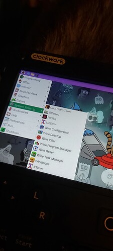

When I click on Sunvox and execute it, nothing happens. When I execute it from terminal it says “Failed to execute child process “xterm” (No such file or directory)” I’m on version 2.1C
Any help would be greatly appreciated. Thanks!
With sunvox theres a few different ones you can try, i use the opengl one thats in the linux arm folder seems to work nicely for me, with renoise i cant help you because im using reaper atm, tbh i dont really have experience with both so might try renoise in the future
Yeah unfortunately I’ve tried opening all of the Sunvox executables and nothing happens, and I get the same error message when I try to execute them from the terminal- “Failed to execute child process “xterm” (No such file or directory)”
Thanks though!
I think this (right at the bottom) is what its talking about, theres also uxterm (also in photo) maybe you can install them. I dont know how i got mine, probably automatically installed with pi apps or pikiss or something installed from those programs.
