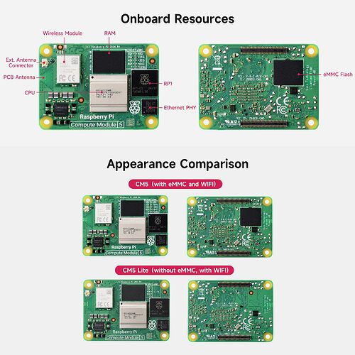

Removing the EMMC module will not let you use a SD card. If you have EMMC then the traces for the sd are not connected in the PCB.
Ok thats good to know, thanks for correcting this i was certain i could take it out of there and without being present it wouldve default to sd…
Havent looked at the layout of the cm5 , without being connected on the emmc versions did they really print a different layout without the trace at all ? Not even options jumper pads ?
Im looking at section 2.13 of the cm5 datasheet i thought that could be adaptable.. but i think i see whats missing .. sdio 2.0..
I have both the CM5 32gb emmc that came with the dev kit and a CM5 lite and just looking at the PCM the boards are different. With enough skill and determination I guess it is possible, but probably a lot easier just to get the lite in the first place.
Different traces really? Im quite surprised they wouldve have the lite version a unique layout when even their datasheet refers to both as same. Especially for one single option, to me a unified board sounds better than having to manage two different pcb that would occupy two shelves instead of one before getting assemblied, and all the suplly logistics to go with it.. im versed enough in 0.1mm pitch soldering and dnp/unpopulated traces that im always game to repopulated the proper way if needed but I am focused into getting the lite versions anyways, i was only to go this way if cm5116000 are completely unavail from being sold out everywhere.

Here’s a comparison image of the two SKUs
