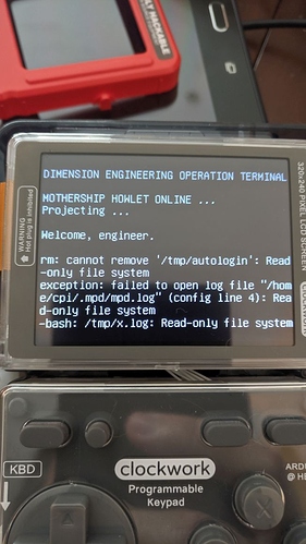

not sure if this has come up, on this build I loose wifi, as in I get wifi when I set up, but a day later when I turn it on it cant see wifi at all (but my old sd loadout works fine)
On this build? As in the 200323? Have you gotten it to work? Unless you’re meaning an older one, since you mentioned leaving it for a day and then having it fix itself.
There have been quite a few cases of wifi dropouts, separate from the custom image. It seems that it’s just a very fragile flaky part of the console. There was a thread showing the tiny ceramic antenna, and a hard fix to improve this. There are also a lot of other threads simply documenting the wifi dropping out. It can be due to far too many factors, no doubt separate from the image.
Re: wifi drivers etc, that would no doubt be kernel dependent. I’m not the maintainer of the kernel, so can’t really comment on it, other than to say that the most recent build contains the original 5.3.6 kernel which the stock 0.5 image uses. If you’re having trouble with wifi, try using that.

Last night, I made the image and uploaded via my macbook pro in Mac OS. It shouldn’t have been a problem, but regardless, I’ve made it “properly” from a debian machine, zeroed the empty space, and made the image filesystem self expanding.
It should be about 2GB compressed. As usual, decompress it (it should be about 6.4GB) then write it to your SD as per normal.
I’ve maintained the same build number, 200323. Assuming that the 200323 never worked for anyone, it shouldn’t be a versioning problem, since the only change is the above zeroing and filesystem expansion. (and I just like the way 323 rolls off my tongue :P)
I am yet to actually test writing it to an SD card. I will do that after I’ve finished uploading the image. It “should” work, but that’s what I thought Re: my initial upload.
Edit: I’ve tested it. It works for me on a fresh card. Let me re-iterate that you will need to let it sit there doing its “thing” for about 60 seconds on the initial boot up. It’s doing a file system expand. Unfortunately there’s no verbose printout on the screen. May I also recommend that you have it plugged into power, in case there is a power failure while it’s happening.

Indeed Shadow Warrior and Blood don’t work on Lima, but I’ve changed it to fbturbo and Shadow Warrior worked. But Blood, is in black screen 3 seconds or so, and goes back to the “desktop”.
I tried all the kernels and just the first one (5306) doesn’t have the flickering, all the others flickering time hehe. Also I tried Blood on all of them and is a no go.
