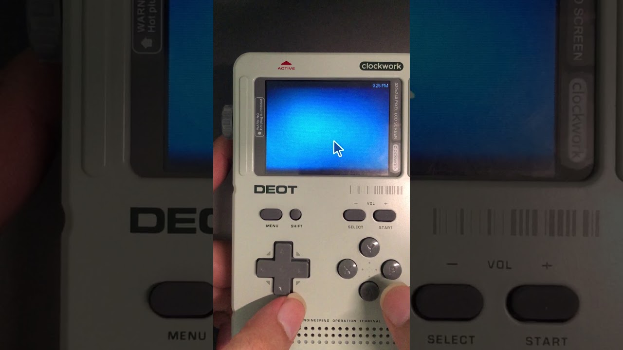

video:
视频:
code:
代码:
Instructions:
使用方法:
Double click on “SHIFT” to switch modes
双击"SHIFT"切换模式
Arrow keys to move the mouse
方向键移动鼠标
“X” key improves accuracy
"X"键提高精度
“A” left mouse button
"A"鼠标左键
“B” right mouse button
"B"鼠标右键

Many applications can’t display the mouse pointer, I only found kodi to display the mouse pointer
很多应用不能显示鼠标指针, 我只发现kodi显示鼠标指针

3
That’s great @xin ! Much much needed functionality! I flashed my keypad and installed scummvm from the apt repo. Mouse works and scummvm is usable but there are problems when playing a game and it needs keyboard keys (well almost all of them need) which are not mapped to the GS keypad. So using the retro-arch core for scummvm is still a bit better.
