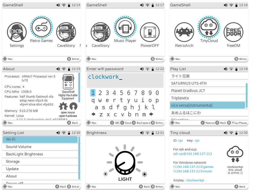

Launcher (in Python)
See GitHub - clockworkpi/launcher: The launcher for GameShell
