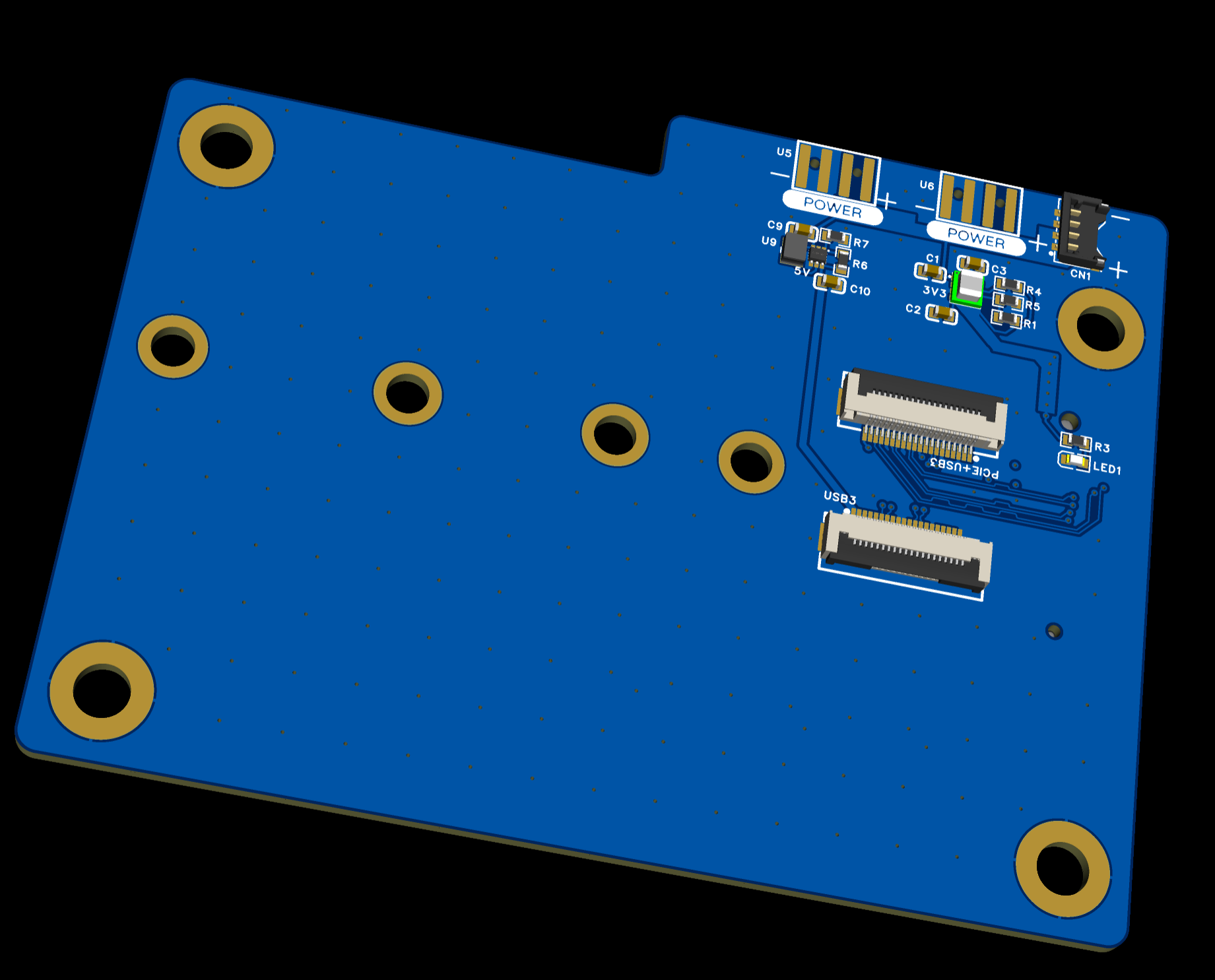

New cm4 back board and nvme(m.2)extend DIY board is coming!!!!(uc and dev)

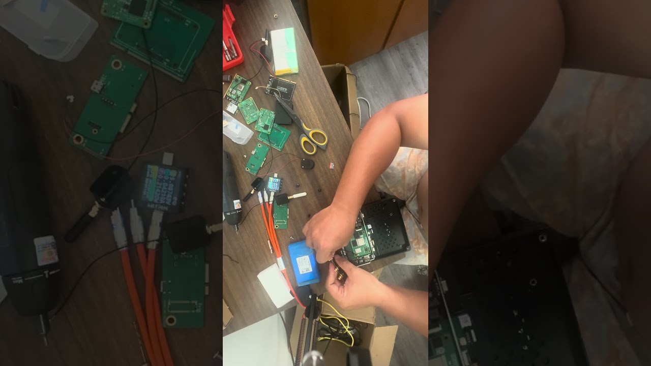

nvme+battery board!!!5days!!(about nvme test!)
will you also be selling that battery adapter for the moment? that looks really nice for an upgrade.
yes,but l dot know how much ?
the last two test ,rtc—fan it works well!!!

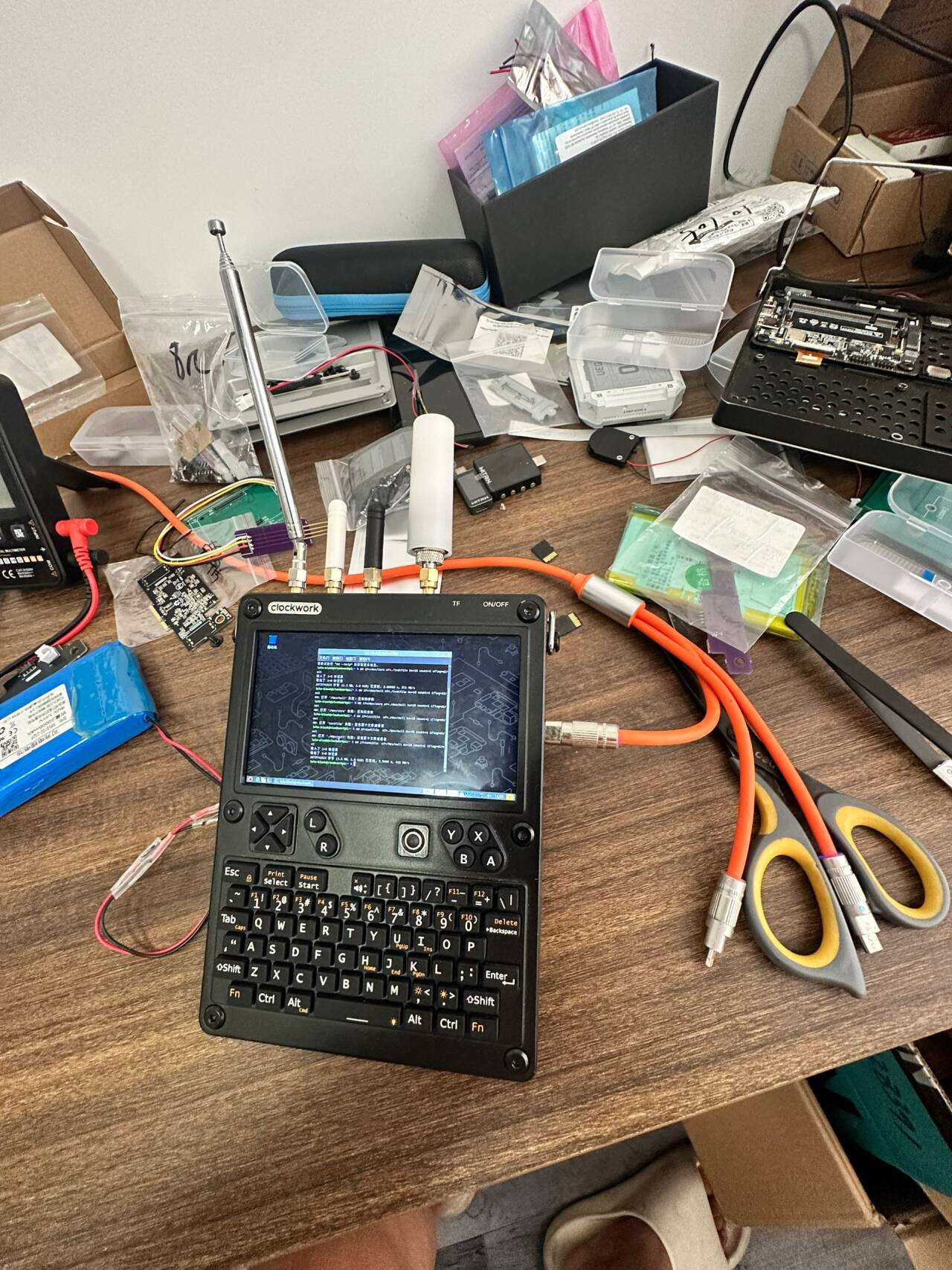

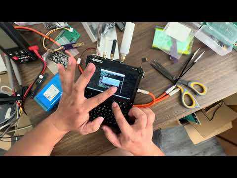

AIO test about USB(antenna is not ready need 2days) battery&nvme board is coming ,another 5days
··························AIO USB test VIDEO···········································
··························BATTERY&NVME &USB3············································

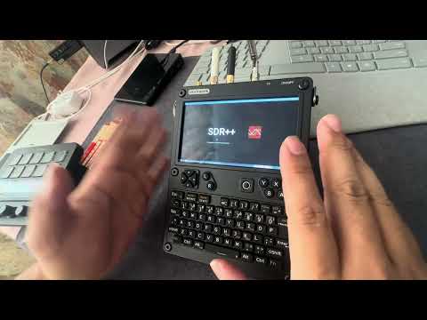

AIO board test(first video is official RTL-SDR v4,AIO sdr sma get wrong antenna sma port second
will compare with RTL-SDR is same situation)

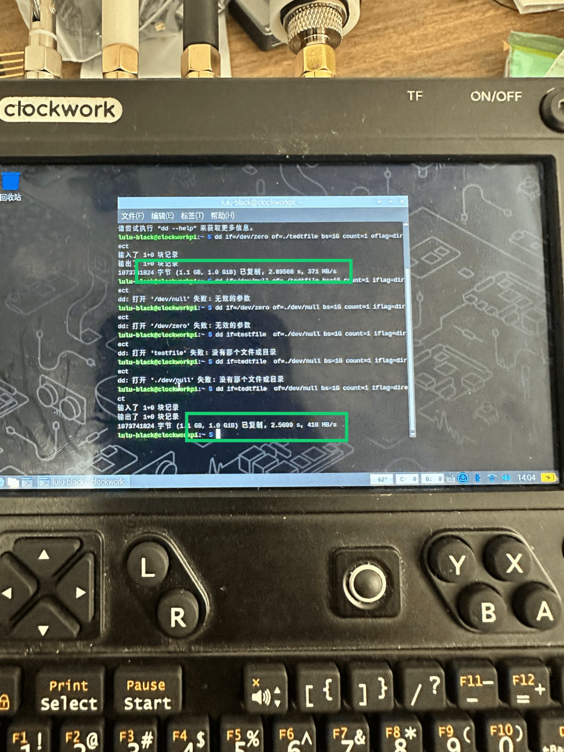

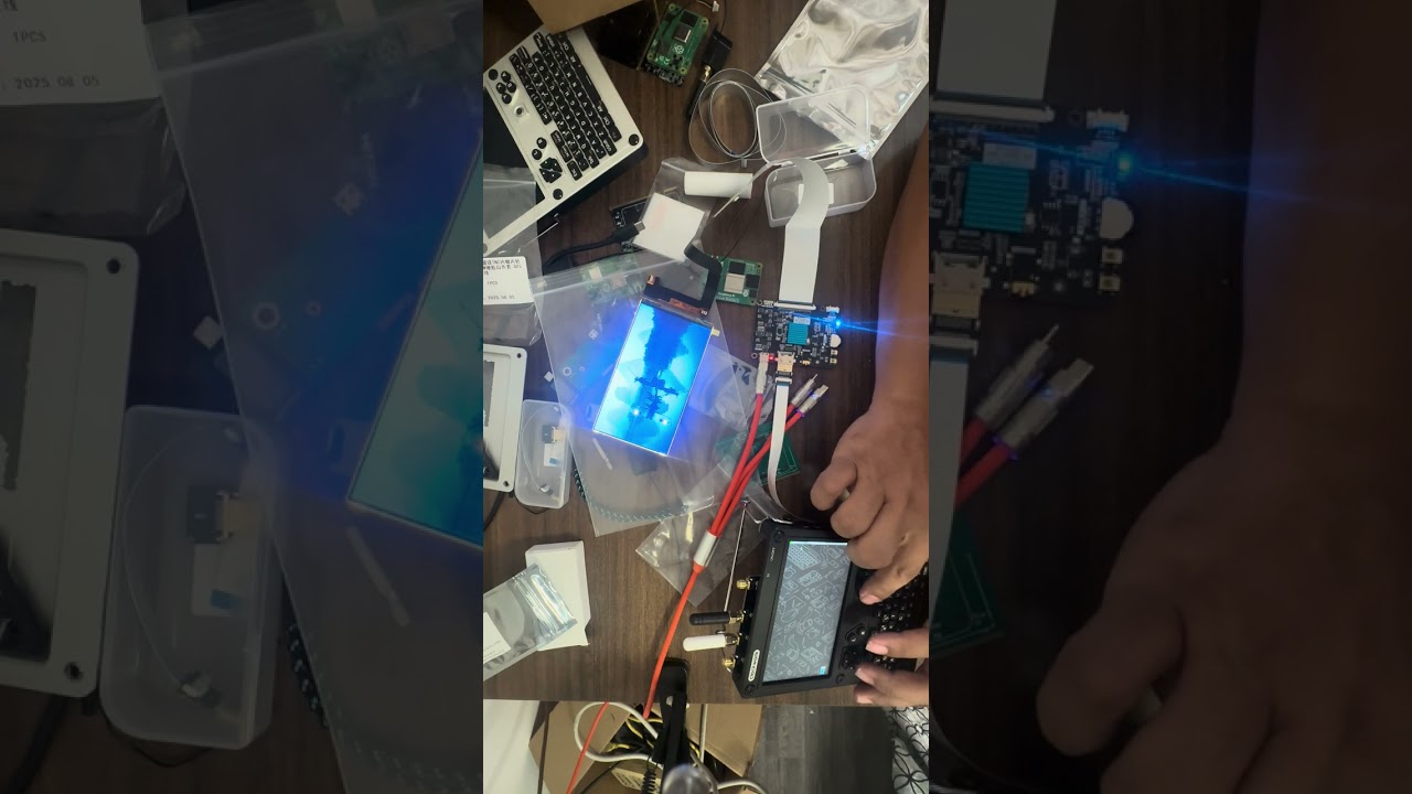

NVME-battery Success!!!
Last test is let bookworm working on nvme!!!
DONE!!!!-NVME work on Uconsole via PCIE!!!(CM5)
@Rex
write 381mb/s,read 400+mb/s

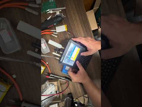

final test about nvme-battery-cm5 expension card!!
everything deal with very well!!But GPS &lora,because,l know little about those,l need time ,fianl design almost done!!below is video!!!
USB3.0 work on uconsole(but 2.0 high speed,mybe the cable problem)
CM5 with emmc start linux system on nvme

Bros, l have to develop another nvme board , expension card—
nvme+ethernet+dual usb-c(2.0+3.0)+4g+gps,10days pls.
