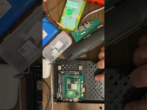

Two Pictures,one is new screen`s drvie board
two is my new home for boards

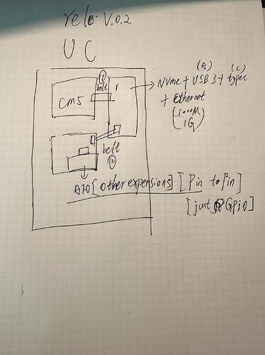

1.the new one,this make the expension card on battery board(if
you just need the nvme,you donnt need to change battery boad&battery,just adopter &nvme expension card is enought)
2.nvme expension card
3.battery board

new double board here!!!No more words,below!!!
this style will be the first on sale one!!
More details!!

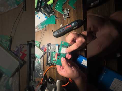

nvme faild again ,but l find problem!!!,wait another five days!!!
boot on usb3.0&tempurature (almost 70,as hot as cm5)

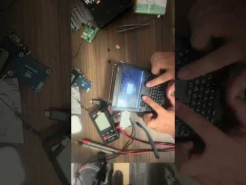

success!!All the thins seem perfect!!!More details tomorrow!l really really need a rest!!See you tomorrow if l can wake up !! l am so tired !!!
