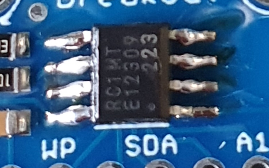

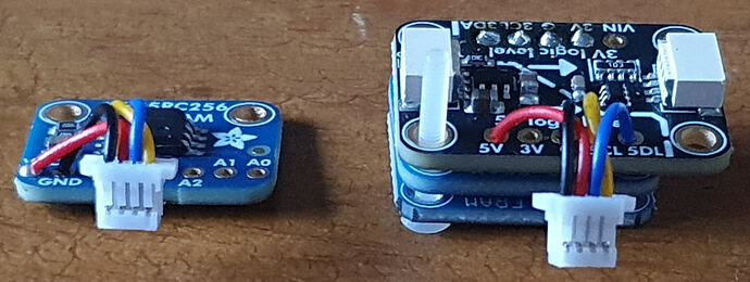

So was I yet still amazed I managed to swap an FRAM chip for 4x more storage :smiling_face_with_sunglasses:. A fine tipped soldering iron and lots of light !. I took photos to inspect my handywork and check for issues, working perfectly with added leg heatsinks :rofl:.

so what are your benefits now? FRAM? What’s that?

Non-volatile ferroelectric ram. Permanent storage, very low power, almost unlimited reads/writes vs flash or sd cards (in the billions), as fast as the i2c bus can go (around 42,000 bytes per second at 400Khz, 8,000B/s if written one byte at a time). In my case storing constantly updating calibration values (xyz magnetometers and accelerometers), keyboard and display backlight learning curves. Air pressures, light levels, temperature, humidity, heart rate and blood oxygen over time… plus anything else I fancy (two piggy backed cards currently in a PicoCalc under a level shifter).
