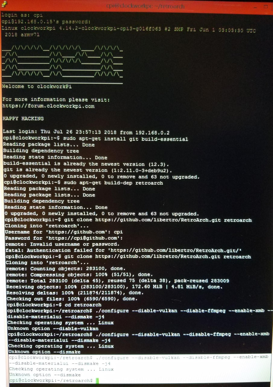

./configure --disable-vulkan --disable-ffmpeg --enable-xmb --disable-materialui --dismake -j4
I am pretty sure that I typed this one in to the command line correctly, but it tells me that I have typed an unknown option. Is this supposed to happen? Or did I make another mistake in the coding?
I have included a picture of this to help explain.

it’s two different commands
make -j4 is after configure runs
make -j4 is a separate command to the ./configure stuff, and you have some stuff missing from configure too. There should be two commands:
./configure --disable-vulkan --disable-ffmpeg --enable-xmb --disable-materialui --disable-flac --disable-parport --disable-vulkan_display --disable-videocore --disable-videoprocessor --disable-v4l2 --enable-x11 --disable-wayland --disable-vg --disable-jack --enable-kms -
make -j4
And then you run this after those two.

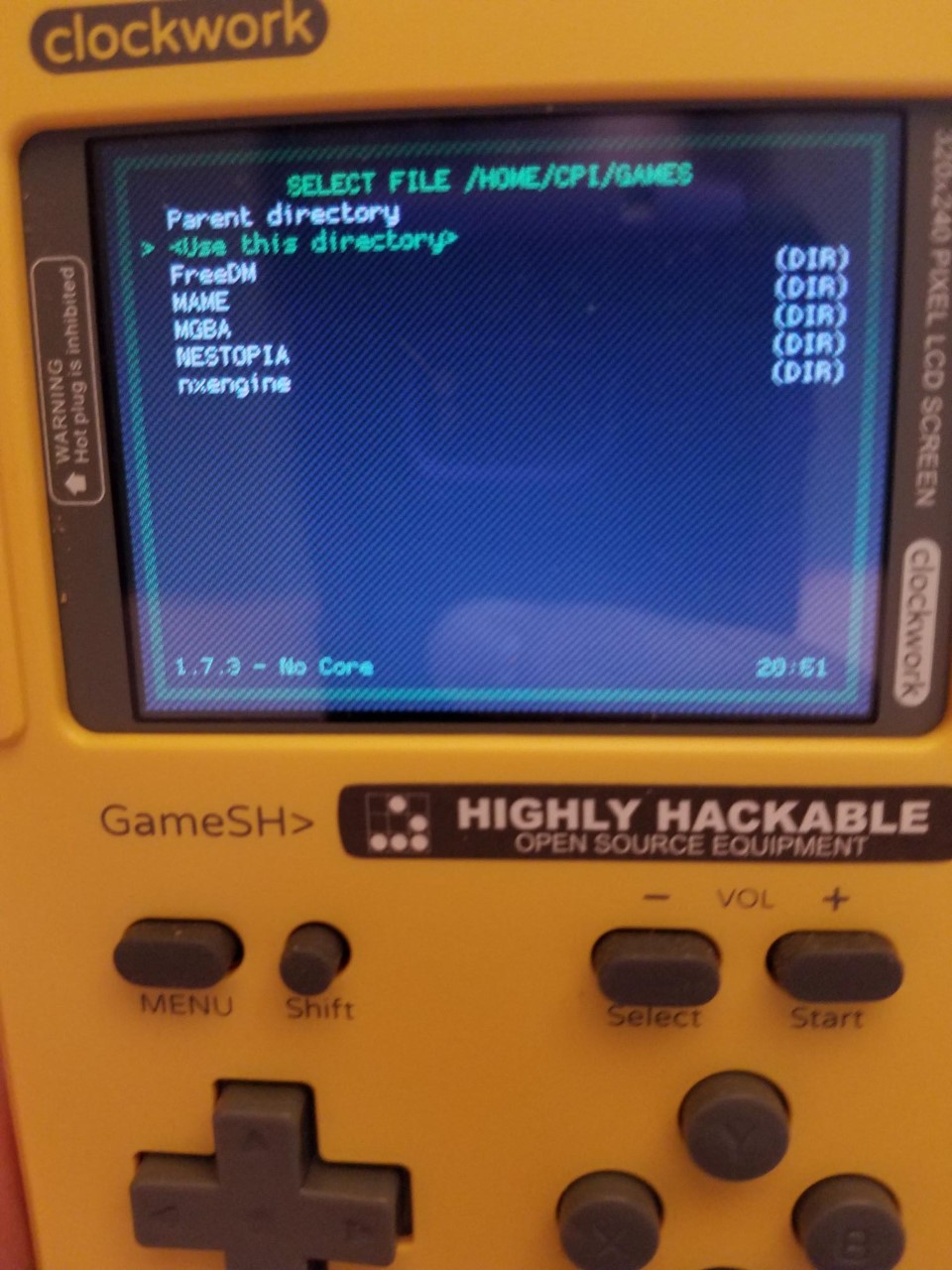

Thank you so much for helping out with the coding problems. I cannot believe I made the mistake of ignoring the slide bar at the top with the full ./configure command line. However, now that I have gotten through all of the coding, I am now stuck when it comes to setting up the directories in RetroArch. I apologize for all of the trouble, most of my experience is with retropie and not with retroarch, and I have usually had tutorial videos to follow along with. So all of your help is appreciated.
My problem with the directories is that I get to the system bios directory and I can find:
/home/cpi/games
but I cannot find retroarch. saves , states, or system for any of the recommendations. I have included a pic for reference to what I am saying.
These directories don’t exist on the GameShell - what FR was recommending is that you create these folders so that you can configure RetroArch to use them. (you can use the mkdir command to make folders).
