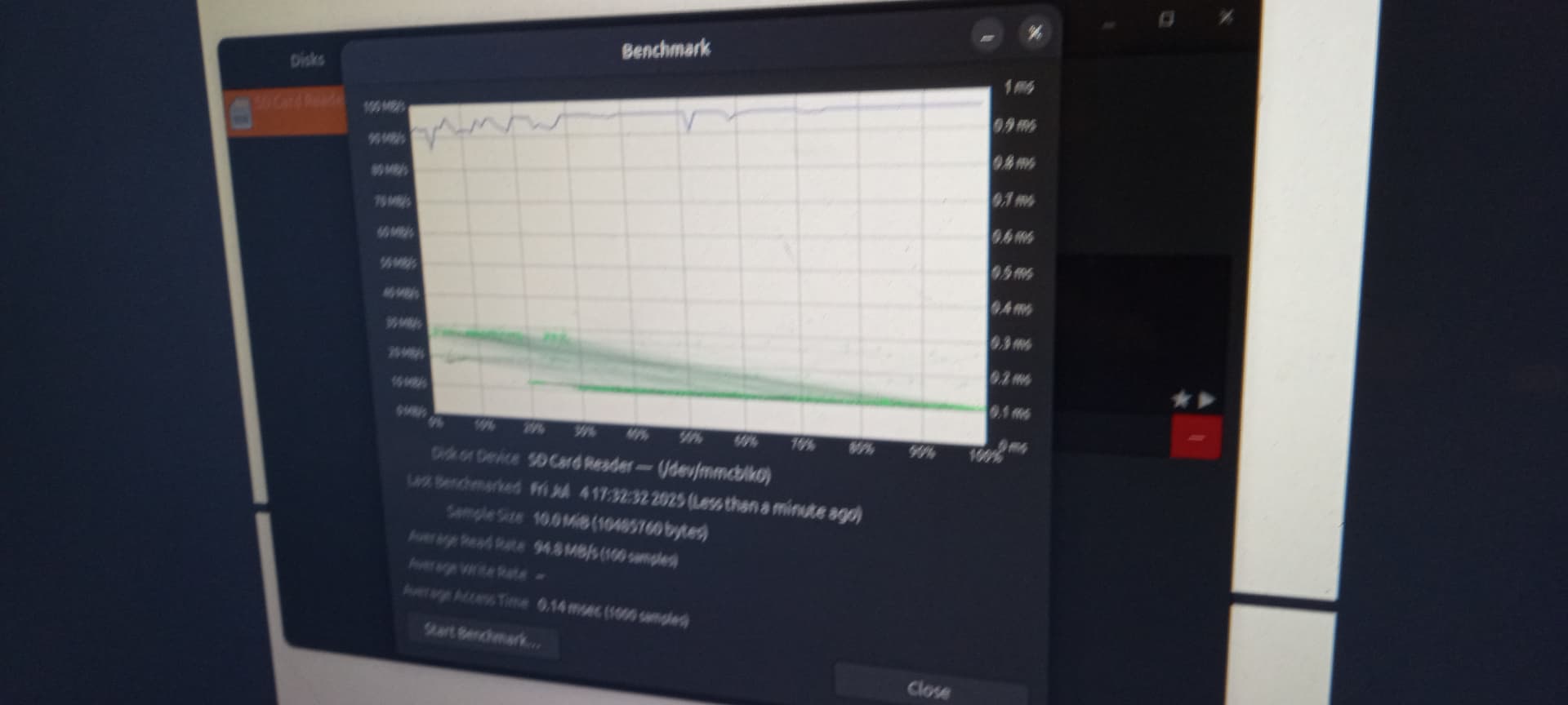

A2 v30 is what you should look into and decent speeds , not endurance only. Plus paying the double for a smasung evo than a team group doesnt makes much sense the day the system goes they wont refund your data. Hense get a second as backup for the same price than one of the named compagny , will get you further for the same buck and by the looks of the reads and writes the team group ultra or pro is probably the best deal atm
the cm4 sd interface is limited at ~50mb/s, so any recent card is fine
I have a cm5 carrier board . And changing the internals of the uconsole entirely because theres a lot of options that can fit in there. Your call i prefer to keep on the SOTA side and versatile.
And honestly i would disagree , since a2 v30 internals are much more resilliant and faster than anything prior to it. Even on my pi400 i see a diff, even on my tx16s (and plurial) i see it way more prime on axcessing data. You do you but from what ive tested its way better. So yea it does a diff
